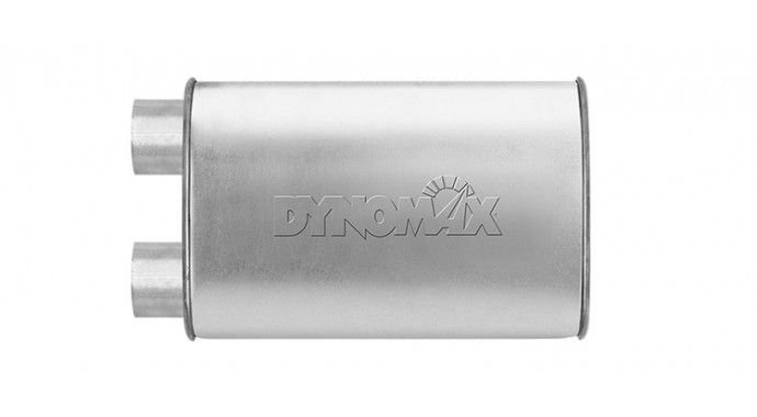

Im in the process of looking for a C5 and wondering about exhaust options. Im actually trying to look for a Z but theres slim pickings out there(in my budget). Ive already got an idea for the Z if i get one, but not a base. Now, Im very particular about how the exhaust will look, as I want it to be perfect. It really aggravates me when I see these exhausts drooping on one side. With that being said, I don't want to change the axle back, so I won't have to deal with this issue.
Now heres my question, is it practical to have the stock mufflers cut out and replace them with something like this?(Same side mufflers)
I don't want anything loud, as I plan to add LTs, catted X, and a cam.
Also, does the stock C5 exhaust have a 2.5 in and 2.5 out setup?

Although i get your excitement I'd wait until you have a Corvette in your driveway, as it might already have an aftermarket catback. 2.50" thru until after the mufflers, then 4 tips total.
I like the Ti Z06 catback, but your idea could work if you find the right size mufflers.

Selecting a muffler system on what you read on line or on someone else OPINION is a CRAP SHOOT. What is loud to one person is quiet to another and vise versa.
The one thing that you DO NOT WANT is exhaust system DRONE.
DRONE = Exhaust note frequency that resonates inside the cabin and makes driving the car a real PAIN! It gets OLD QUICK!
I put a dynomax cat back system on my 85 C4 Coupe and it made the drone so bad, the wife refused to ride in the car. It was really bad but I put up with it till I sold it.
Cant say what it does for the C5.
If it were me, I would personally EXPIERENCE an installed system on someone else's car. Take a ride in it. If you like it, copy it!
Always look for a good used system. MUCH better price and they usually are still like new.
What ever you purchase, here are the facts:
An aftermarket exhaust will NOT add GOBS of power to the engine. 8-10 Hp 12 hp on a good day.
Purchase a system for the improved exhaust note and rear of the car looks improvement
What ever exhaust system that you purchase, headers will make it a little louder , Cam and heads will make that louder and maybe even add a little drone.
My 02 ZO6 Stainless Works system form the headers to the tips (to me ) was perfect. Nice idle note and wicked WOT scream (ZERO DRONE) PERFECT!
I added patriot stage 2 ported heads, a big cam and the system is LOUDER and I have just a little drone. Nothing bad but, its there.
I agree!! Get the car, talk to other C5 People and listen to different systems. Get a feel for what you like and don't like before you spend $1000- $1200 on a cat back system and find out you DONT LIKE IT! Seen that happen TOOOOOO MANY times!

You can't have your cake and eat it too------The factory setup or an aftermarket cat back that uses the same plumbing route as shown in the photos is very restrictive--- there are just too many 90* bends----
For best power you would want a straight thru type muffler--However as Bill mentioned some create resonance---like the Dynomax----however there are some that have no resonance like the Billy Boat bullets and others
There isn't a lot of HP on the table anyways--no matter what manufacturers claim---They all average between 5-12 RWP----The straight thru design offers the most--
I change mufflers all the time simply to try other brands--there is never any huge HP advantage but the sound changes--Mufflers are a personal choice on what sound you like---Most people don't enjoy or agree on the same sound---
Seems you are planning future mods like LT's and a cam---A restrictive cat back exhaust will not allow the full potential of those mods--
