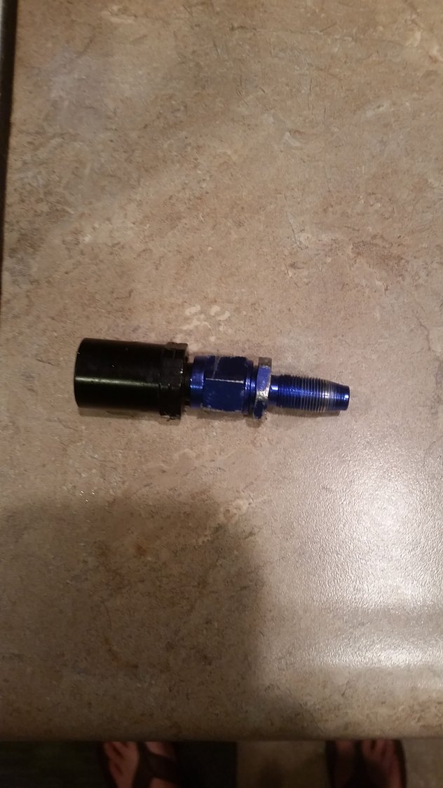

Ok that sheds some more light on the situation then. Well I was reaching around for the master and located a fitting that was dripping gas if I moved it very much. Found out it has a walbro 480lph fuel pump so I need to get this fixed first bc that could be a huge problem. One of the o rings has a small chunk out of it. So I'm sure the fuel pressure is out of wack

Now I need to know where I can find this fitting? Local auto parts store have this? And also taking the computer out this weekend and sending to shortuning for mail

Alittle update on my frc. Replaced the fuel like end that was leaking and it now runs 100% better. Just minor surging. That is nothing a tune can't take care of. Took it down the road and it shifts and takes off alittle better than it did before. Still pulls hard as hell through all gears.
