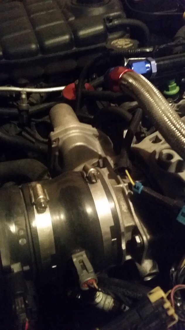

And I can't tell what kind of throttle body I have. If it's stock or aftermarket.
The injectors are green tops skm.I'm figuring they are 42lb injectors.

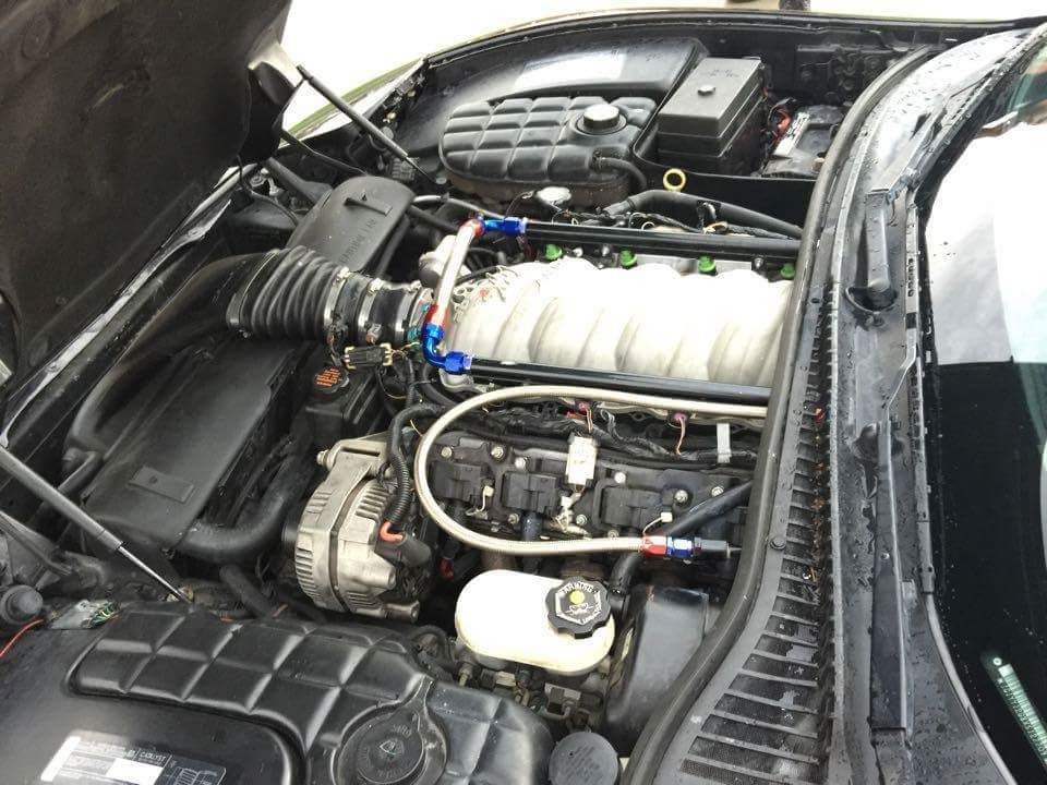

That's an early LS2 OEM TB. That's what will bolt to it. The LS1/6 TB will NOT fit the FAST manifolds or the C6 OEM manifolds.
Heres a comparison shot of the LS1/6 and LS2:
I ported both
