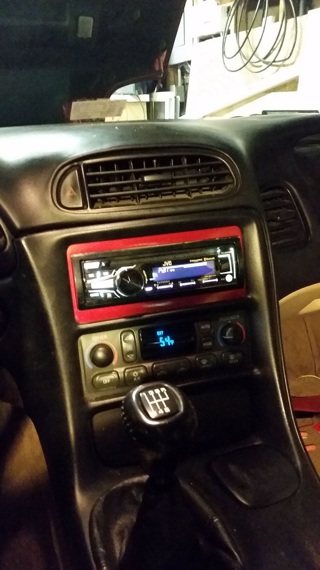

Default C5 head unit install
JVC head in my magnetic red 00 coupe. <br/><br/>Thoughts on the red trim adapter?
Old Jan 16, 2016 | 08:35 PM
Posts: 368,384
Likes: 24,790
Perhaps if you had a mod red interior it would go well with it, but otherwise, not something I would do.

ryanman95's Avatar
ryanman95
Joined: May 2014
Posts: 39
Likes: 6
There's 47 brand markings on this car already. I didn't really want to add another. Although I like the idea of backlighting. I went for cost efficiency here. I didnt want the cheap crappy black bracket, and can't spring for a DD conversion yet.

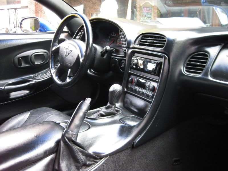

Paul 75 L82's Avatar
Paul 75 L82
Joined: Dec 2000
Posts: 5,245
Likes: 25
From: Blue Ridge Georgia

Originally Posted by Paul 75 L82
Man, that interior is shiny. Do you have to wear sunglasses even on cloudy days?
