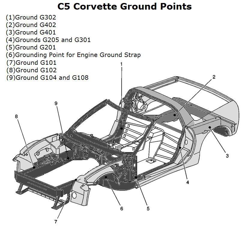

I wouldn't be too concerned about it. Reset it and see if it comes back. Just one of the many electrical gremlins that pop up and go away. Did it have a H or C beside it?
Get a trickle charger. These cars are notorious for killing batteries.
If you felt froggy cleaning grounds may be a good idea.
