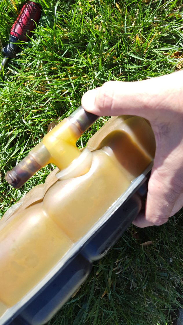

Hope you fixed the leak.. I found this thread after finding a small crack in the coolant tank just as described above.. Just for others to reference.. Mine is a 98 with 75K miles. New tank is on the way ($80).
