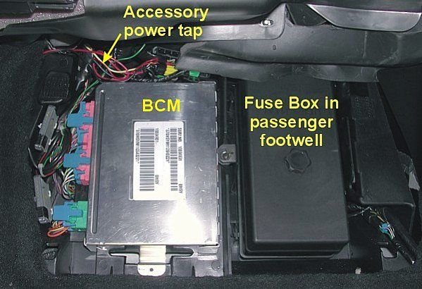

Both, PAC and METRA, work on 97-04.
The only thing is that using the PAC requires bringing switched power to the new head unit.
For the 97-03 models (and you have a 2003) in the passenger's foot well behind the toe kick panel and to the left of the BCM are three wires that are blunt cut and taped over:
1) Black is ground
2) Yellow is switched power via fuse #11
3) Orange is hot at all times via fuse #7
These wires are not present in the 04 C5, therefore power has to be provided from a different source.

The Red wire from the new radio harness must be connected to a switched ignition source in the vehicle because the factory radio connector does not have a switched ignition source.
Therefore, you should connect it to the above mentioned Yellow wire in the footwell because it is the one that supplies switched power out of those 3 wires.
By the way, the Blue/White from the new radio harness needs to be connected to the BLUE on the Pac harness. If this is not done, the Bose amps for the door subwoofers will not turn on and the system will sound real bad.

Old Jan 31, 2016 | 06:47 PM
bajapointe's Avatar
bajapointe
Joined: Apr 2006
Posts: 2,583
Likes: 5
From: Coast to Coast
Here is a picture of where the switched power wire resides in the passenger footwell. Upper left side of BCM.
Old Jan 31, 2016 | 06:50 PM
bajapointe's Avatar
bajapointe
Joined: Apr 2006
Posts: 2,583
Likes: 5
Wires were wrapped in duct tape and were quite sticky with adhesive...I used charcoal lighter fluid to clean them...much easier to strip wires after that.
