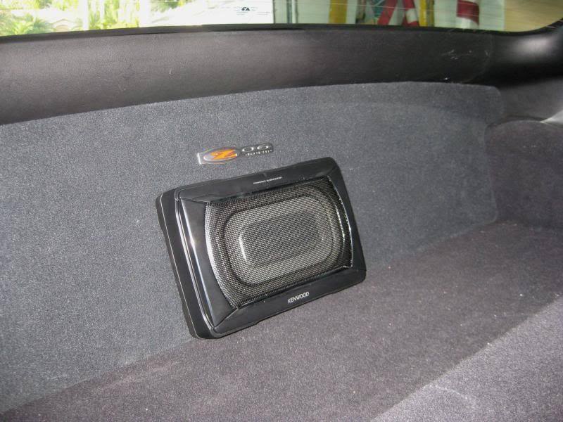

Old Feb 5, 2016 | 04:22 PM
Paul 75 L82's Avatar
Paul 75 L82
Joined: Dec 2000
Posts: 5,245
Likes: 25
From: Blue Ridge Georgia
This little powered sub woofer kicks ***, I love it.
