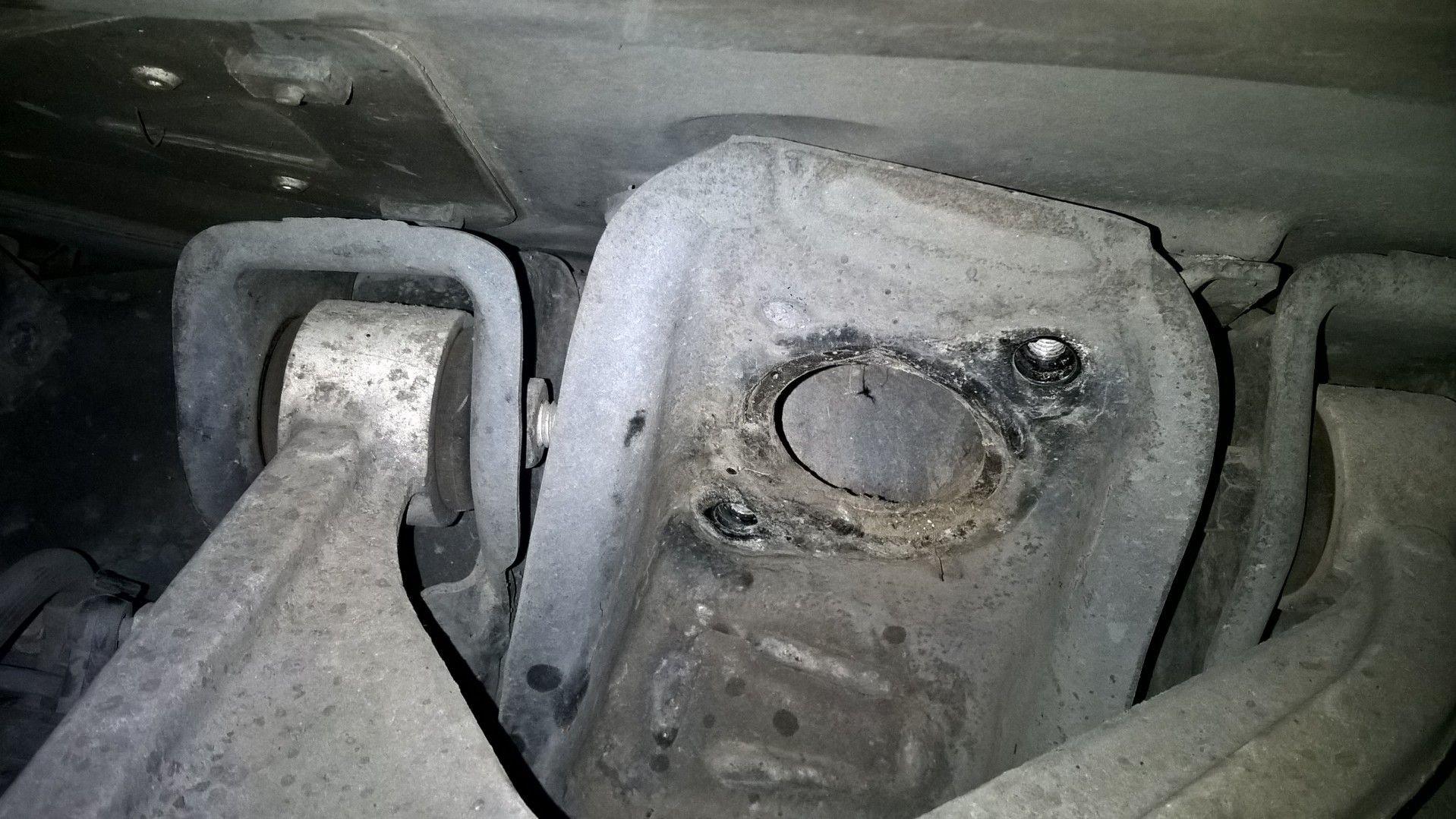

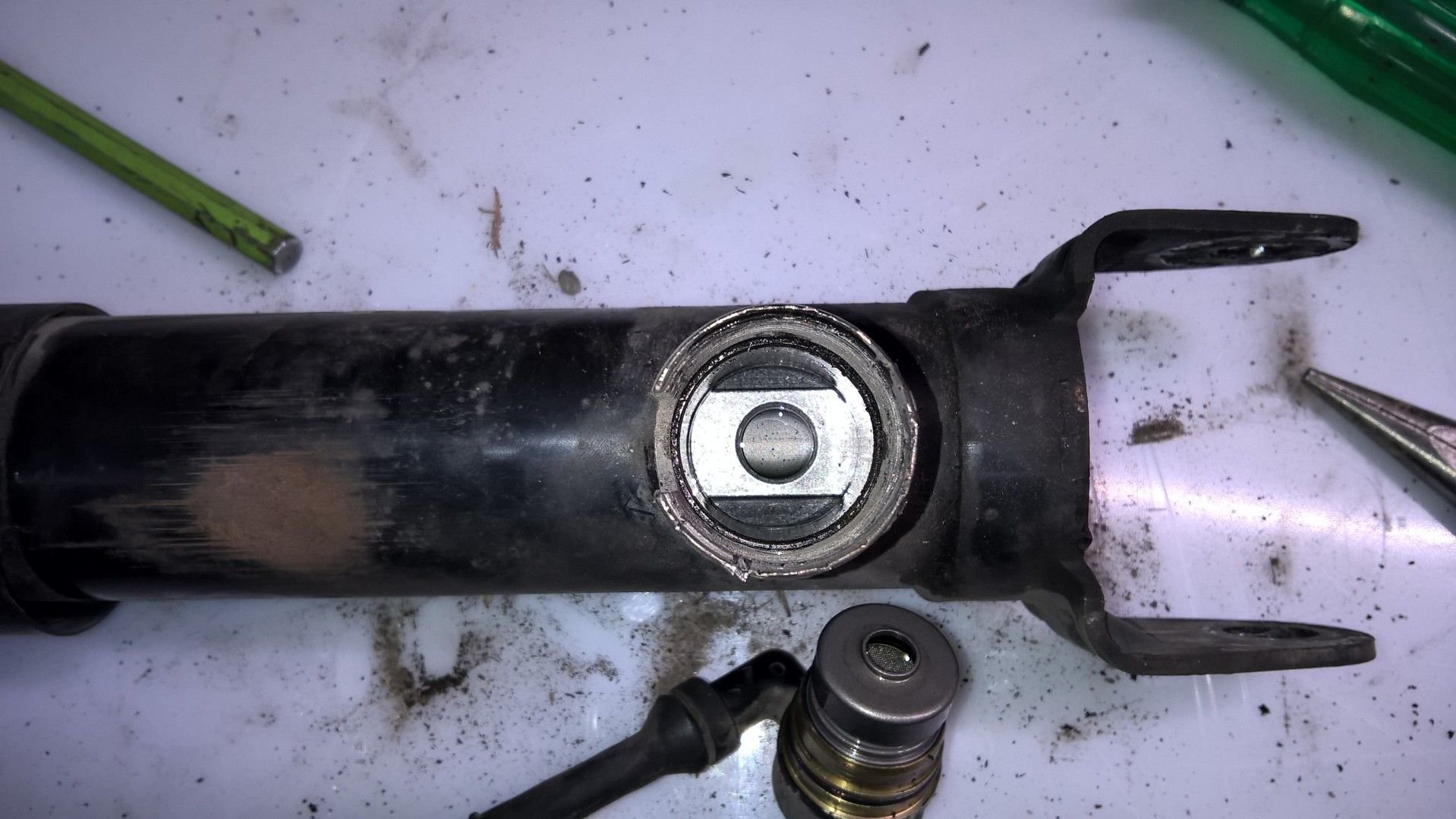

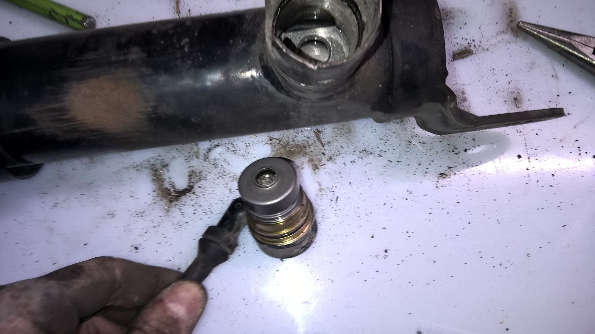

I replaced the stock "electronic damping" shocks on my '97 with the C6 Z06 shocks a few weeks ago. Very straightforward, just needed some muscle.
The stock shocks were very easy to compress by hand on the car. I used zip ties to keep the new shocks compressed, then simply cut them after the shock was in place.
I used a quick clamp to compress the news shocks instead of my arms, which made the process much, much easier. Compress the shock, wrap a few zip ties around the shock, place the shock in position in the car, cut zip ties and torque bolts.
I've included images of the "electronic dampering" shocks just in case.
Electronic sensors from old shock

Upper mount point for rear shock
