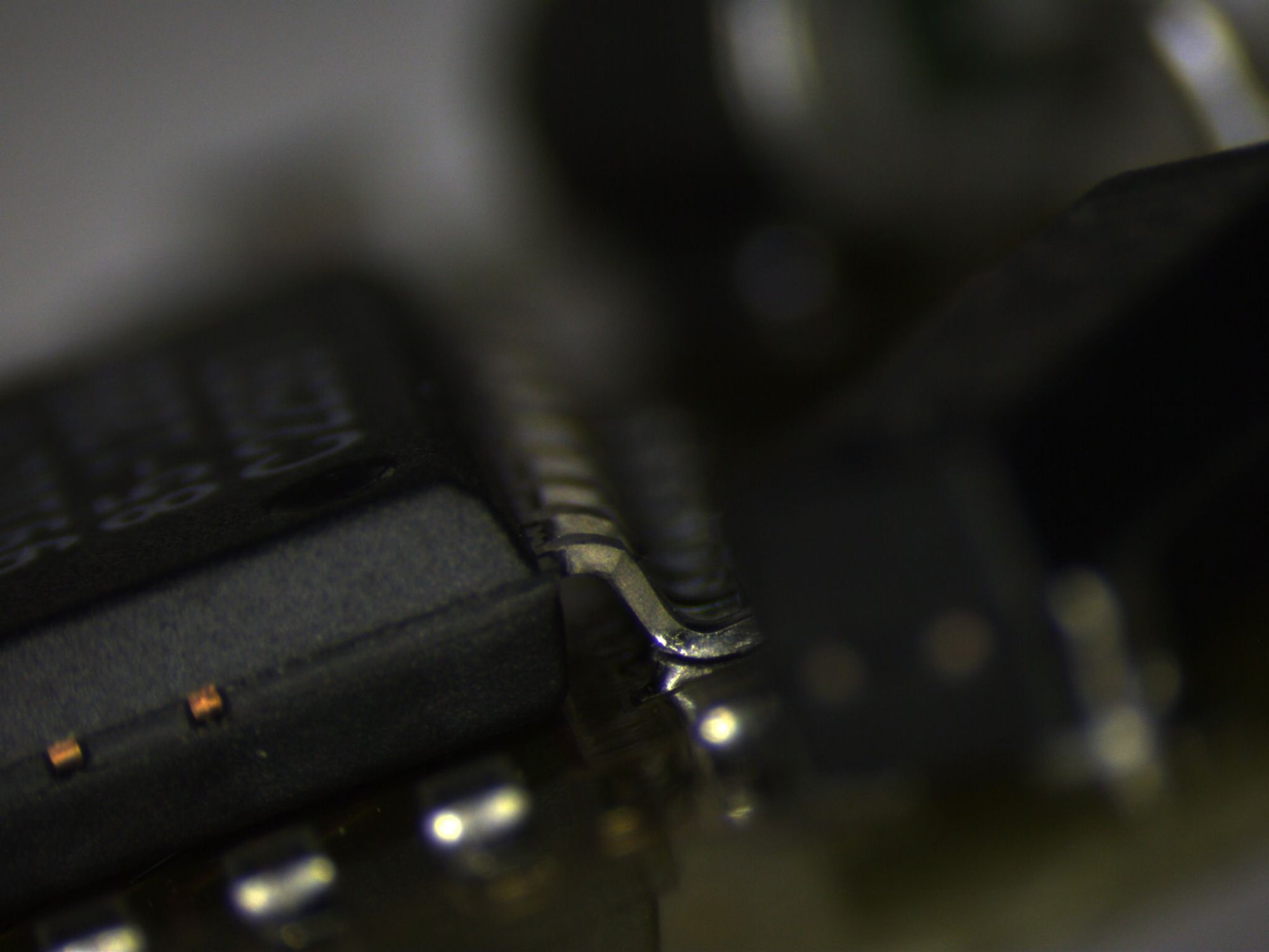

Old Feb 29, 2016 | 12:39 PM
v6turbo87's Avatar
v6turbo87
Joined: Jan 2016
Posts: 524
Likes: 126
From: Sandown NH
Notice the bad solder joint on Pin #1 of the chip.
That is the power to the chip!
I just bought a 1999 and the key fob was not working. Battery was dead. Replaced it was able to learn the fob to the car. Worked for a while the would not work. Could get it
to re-sync but then it would not work again. I then read about the bad solder joints on the Fob's circuit board. I brought it in to work this morning and put it under a microscope and took the picture above.................
I reflowed the solder and the Fob works fine now!
Chris
