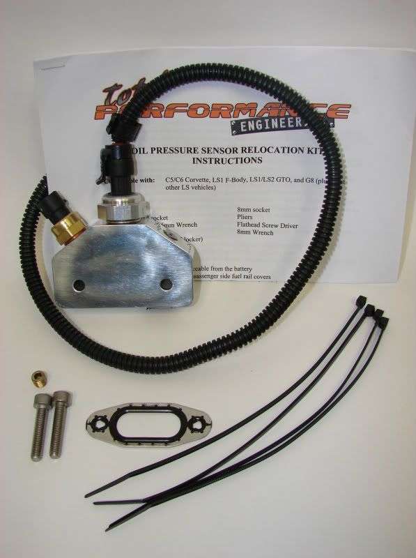

Is anybody doing something similar to TPE's relocation kit (2nd version)?
Old Mar 2, 2016 | 09:08 PM
LoneStarFRC's Avatar
LoneStarFRC
Joined: May 2001
Posts: 36,836
Likes: 244
From: Dear Karma, I have a list of people you missed.
St. Jude Donor '08-'09-'10-'11-'12-'13-'14-'15-'16
Not to my knowledge. I've got one on my car and it's one of the best upgrades I have ever made.

It's a shame no one has decided to pick up this baton Of all the relocating solutions I know of, this seems to be the best one.

The heart of the system is the aluminum mounting block with it's drilled/tapped provision for the 16mm threads used by the OE OPS, directly alongside the threads used by the Oil Temp Sensor in a side-by-side configuration.
All the remaining items (gasket, wiring extension, etc) are fairly easily found parts.
It's having that 16mm threaded hole for the OPS that's key.

The primary reason most everyone wanted for the relocation was twofold:
1. Get the sensor away from the hostile environment it lives in (resulting in a MUCH higher than normal failure rate, regardless of brand name or material) resulting in GREATLY reduced failure rate
2. Easier to service in the event of a failure going forward.
It has been my observation over the years, after having read hundreds of user experiences and/or recommendations on this subject, that getting the OPS away from the OE location alone, appears to greatly reduce, if not eliminate the very high failure rate. This high failure rate is so prevalent, that there has been a permanent sticky-thread on this subject at the top of the CF C5 Tech section which still exists to this day. It is one of the all time longest threads in CF history.
In that regard, (and after having several sensor failures myself) I installed a relocation kit a number of years ago which uses the stainless armored hose and various fittings to re-route the OPS over to the ignition coil #5 and #7 location. Not the most elegant solution, but very effective nonetheless. Result? I experienced no more OPS failures of any kind for several years.
The only reason I used the hose type kit is because the TPE kit was no longer available at the time as they had gone out of business. About a year and a half ago, a CF member had a TPE kit for sale, and I bought and installed it to replace the other hose unit, which I still have.
HTH

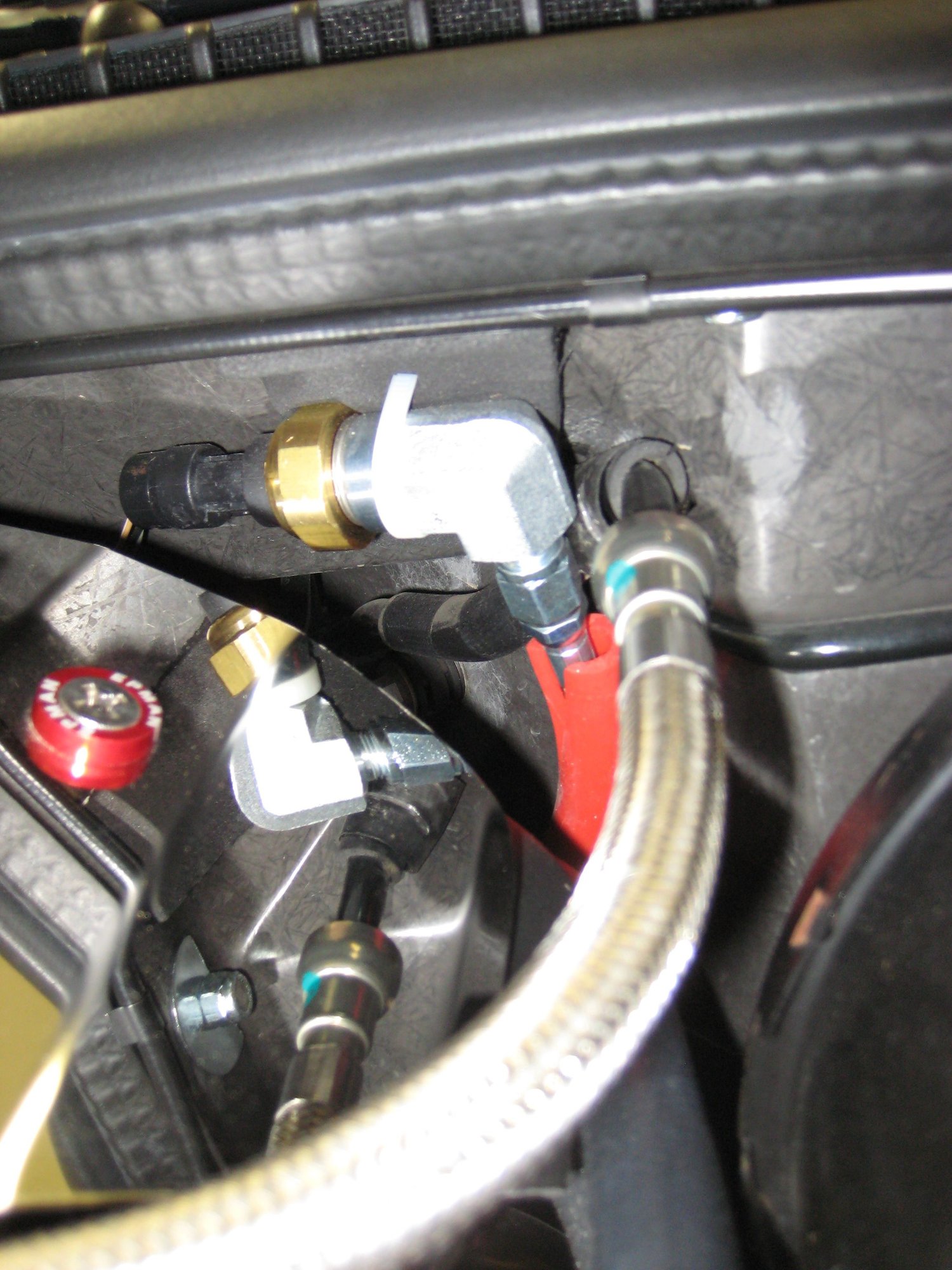

The Parts I used...
