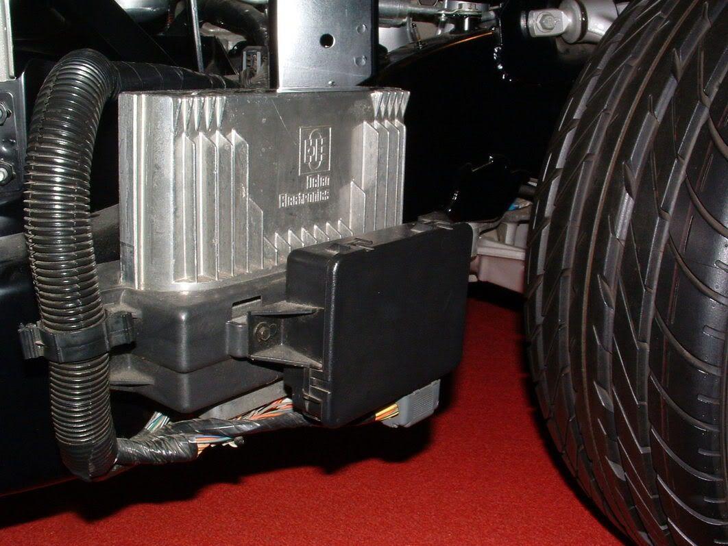

Is it necessary to remove the fender to remove the ECM on a 99 C5? Unable to see the bolts on the left side of ECM.

take off the right front tire, remove inspection cover, PCM is held to the frame with a plastic holder,not real difficult, if the car is high enough off the ground. A mirror helps also !!!!

Pic courtesy of Bill Curlee !!!!

NO NEED to remove anything but the inspection cover in the wheel well:
