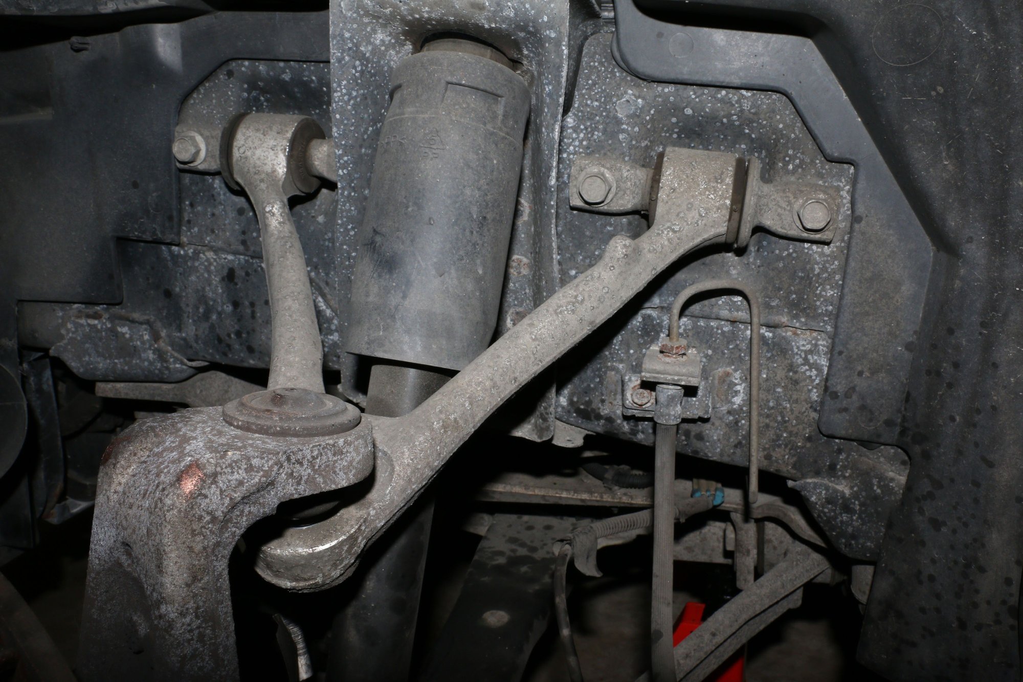

Anybody have an idea of what these white spots are?

YES Its aluminum OXIDATION. I bet you live in or near the SNOW BELT or that car use to live there! LOL!!

Bill it's on the steel frame also,I think it's good (bad) old road salt !!!!!!!!!!
YEP!!

Tips on removing? 3100 psi pressure washer work?
I would be careful with that, rather see you use something like wd40, Evil Twin uses this !!!!

Yep. Definitely salt stains. Believe me, I know.
To neutralize/ remove it, I would spray the whole area with a vinegar solution, wait a few minutes and then rinse with a hose. That's it. You could also use a commercially available salt stain remover made for carpets. That'll work.
