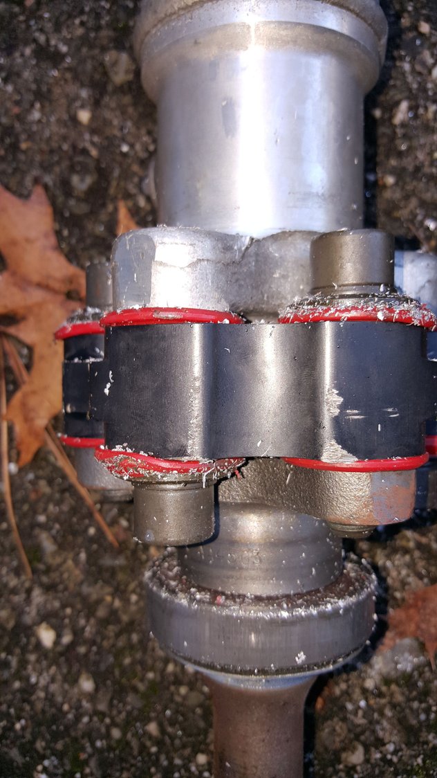

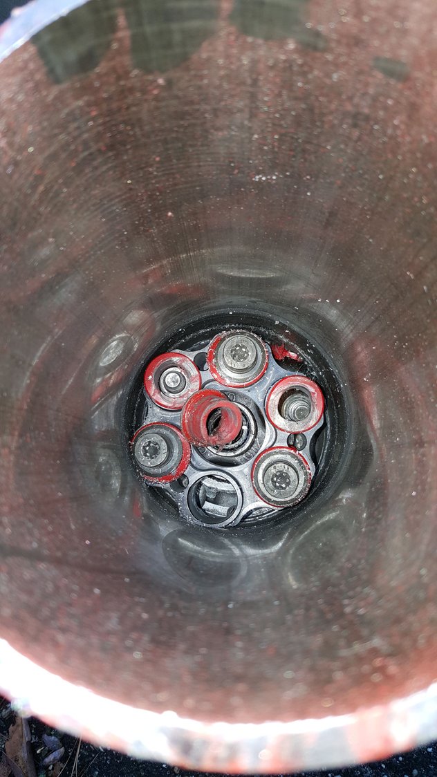

Poly inserts failed
Even the rear coupler poly inserts were bulging and coming apart

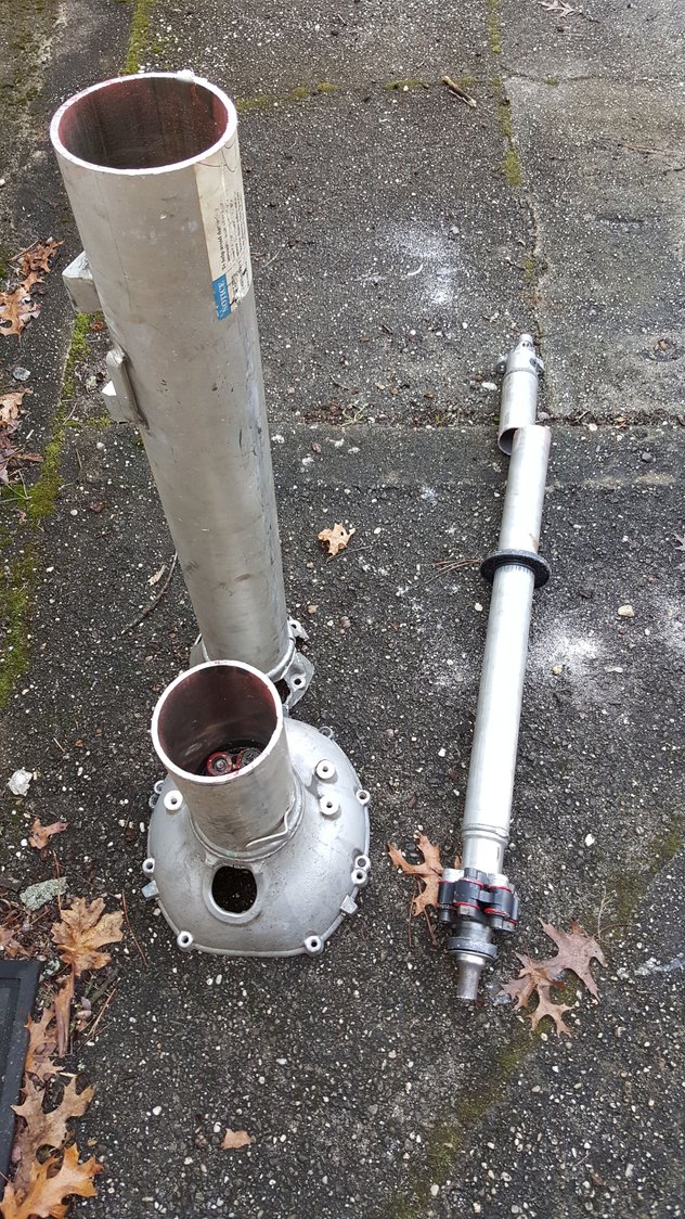

After removing the snap ring the drivesaft would not come out. Had to cut the TT in half because I wanted to try to salvage the couplers
Slightly Used TT for sale $100

I see 2 bolts that backed-out being the cause of that coupler falling apart.

Brother,, I've see SEVERAL to those PROTHANE couplers fail exactly the same way. There have been several post on them failing.
Here is a statement by PATCHES that I thought was interesting:
Originally Posted by Patches View Post
FYI, I recently tried to buy a Protahne Six-Shooter coupler to inspect it and see if I wanted to use it instead to the DSS poly coupler and was informed by the vendor that they have stopped selling the Six-Shooter while the manufacturer redesigns it before resuming production. Apparently, they recognize there is an issue with the current design.
