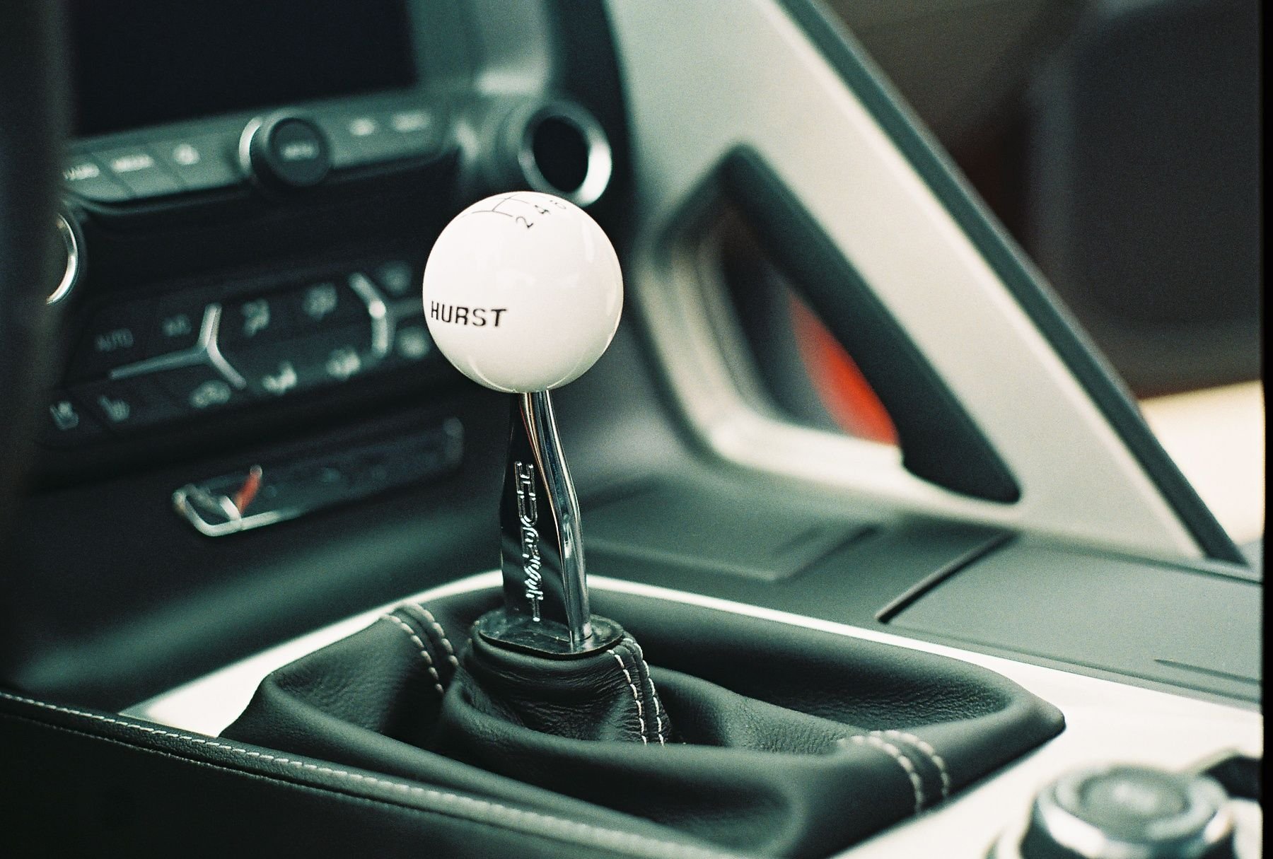

If you like the retro look of the old rectangular chrome stick Hurst shifters with ball ****, check out the Core Shifters version for Corvette.
All the lower shifter boxes are the same for C5-C7 so you can move it to another car if you trade up...
