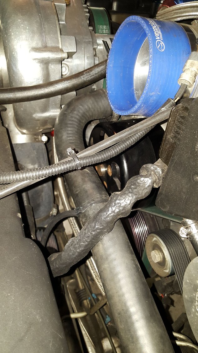

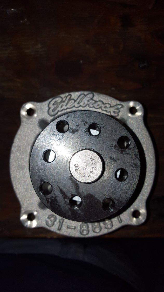

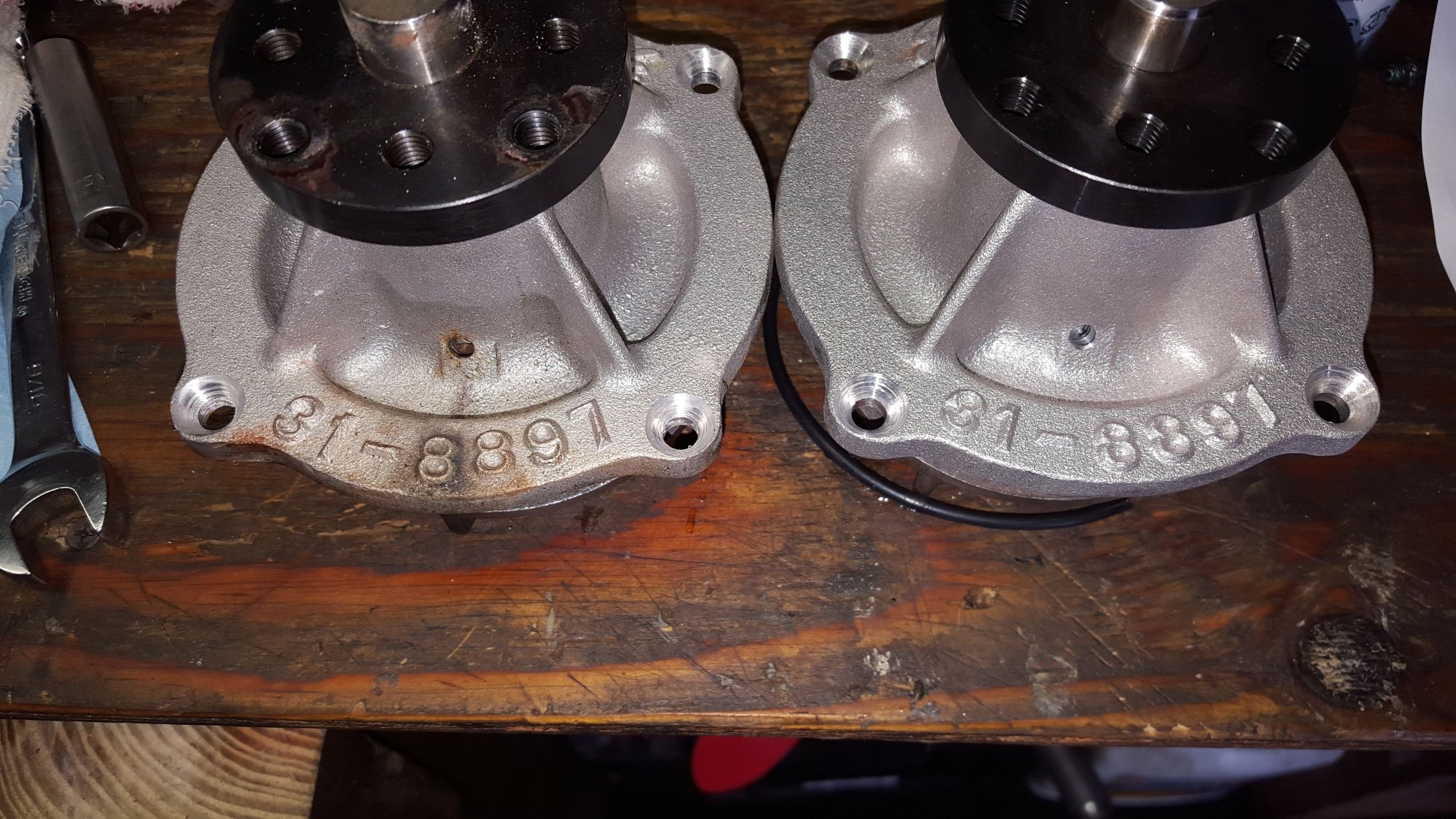

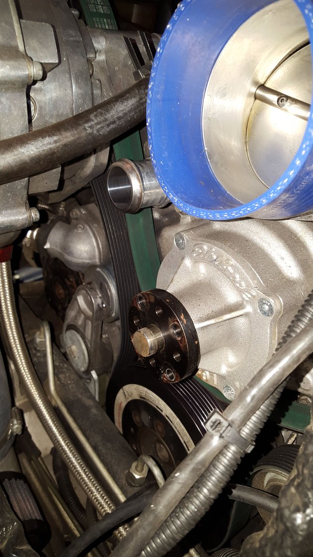

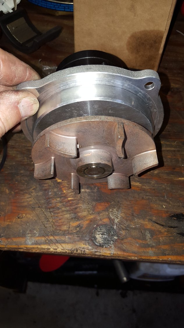

My Edelbrock WP pulley had a slight wobble to it when I grabbed it,Also started to leak alittle,So I thought I had to buy a new one,I did some research and found out you can just replace the guts without taking the WP off I do have a supercharger,Must have had the belt alittle to tight,But any way it was alittle bit of a PITA,But not having to take the WP off is priceless! All I did was take off the top radiator hose and the intake tube and that was it.

The "modular design" plus their claims that it moves a bit more coolant were the reasons I chose it.
I really like the ability to change the "pump impeller capsule" (so-to-speak) without having to even touch the 6 mounting bolts. Drain the coolant and remove 4 bolts. Viola!!
