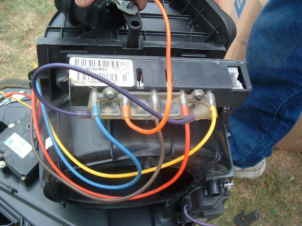

Update. Using a basic vacuum actuated heater bypass valve $15, a vacuum T, and about 4' of vacuum hose you can prevent blend door issue that causes hot air to be blown out while A/C is on, mine was passenger side door. I am up at 3am when it is necessary for heat and then 80 degrees by the time I leave work. I had no desire to open and adjust the valve manually every day. I also have no desire to spend 8 hours taking the dash apart to repair properly.
Install heater core bypass valve and run the vacuum hose through firewall grommet. T into the orange wire that controls the air intake. This will bypass the heater core when the recirculation mode is selected.

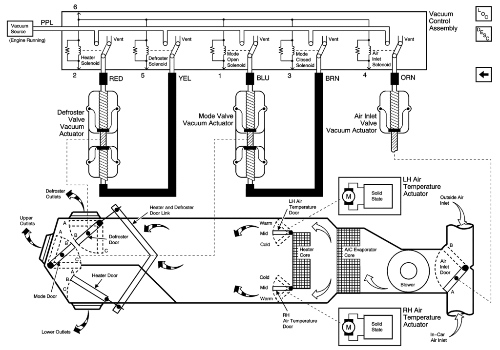

I have a blend door bad and do not want to remove dash to fix it at the moment. Have a vacuum actuated heater core bypass valve installed. Wondering if there is a vac line that is only actuated when you press the A/C button that I could attach to valve??
I have attached a few pictures. I am not really versed with automobile vacuum systems but it looks as though the only way I could get a "button" on the dual climate system to actuate vacuum somewhere would be to use a "mode" selection to pull the valve **** and block the engine coolant from coming into the heater core. For instance I think it would have to be hooked up to say floor output and that would pull vac on the floor line and T off to the bypass valve. I was hoping I could find a line going to max AC and have that pull vacuum but I am not sure.
If I could find an electric vac pump or electric vac valve I could just wire into the max Ac switch with a relay.
Very sorry for the long post. Been up all night and rambling!
Any help would be appreciated! Any comments on "fixing it right" please keep scrolling.

Vacuum bank for climate control<br ><br >
