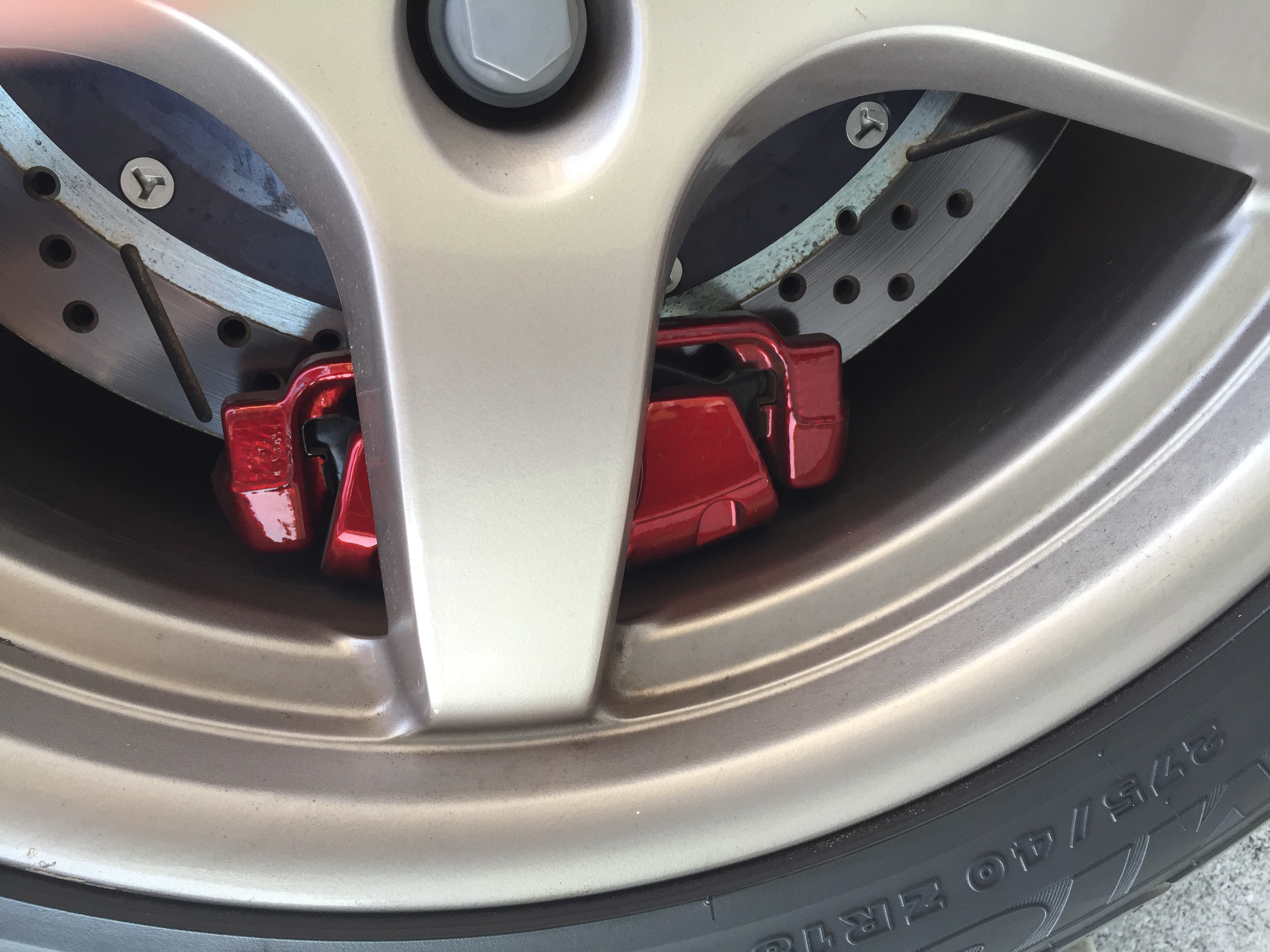

I just had a tire shop balance my wheels. They put the weights where the calipers are located and then backed the car out of the bay scratching up all four wheels.
Looks like all wheels need to be stripped and new powder coat.
My question is what is the correct way to balance these wheels?
What did the factory do?
I also need to reapply the yellow "magnesium" words. Anyone have any idea how to get this done?

Oye- the factory used the champagne colored weights and put them on the outer lip. As you've seen they cannot be put on the inside.
These specially colored weights are expensive and I'm not even sure if they're available anymore. What I did- was tell the wheel shop to put the sticky weights outside (I even go as far as to write on painter's tape "weights go on this lip" so the people at the tire shop do it right), then I use Duplicolor touch up paint to paint the weights a close color. Make sure you go to a shop that specializes in special/expensive rims for tire mounting, or you risk getting your rims all scratched
Curious- the rears should not have hit the calipers though- the smaller brake and larger rim diameter does not have the clearance issue.
I have Baer Eradispeed +2 rotors on the rear. You can see in the photo they fill up the rim.
They also managed to scratch up the powder coat on the "candy red" calipers.

Ahh, well that explains it. Yup, balance the rears with the weights on the outside too.
Quick question. Why is the pad only partially contacting the disc area? Very strange.
Not normal to have that much of the disc face not making contact. You're taking a big loss in braking efficiency.
Had the same problem on a 62 impala with baer brakes, the brackets were wrong. Your pads are probably worn like the disks. I sent pics to Baer, they sent new brackets.

Agreed. The pads actually appear to be reversed in the calipers by the picture. The round edge is usually on the outer edge. I'd get with Baer for sure.
It might be cheaper/quicker to find another set of wheels and sell the ones you have now to someone for a daily driver or racer.

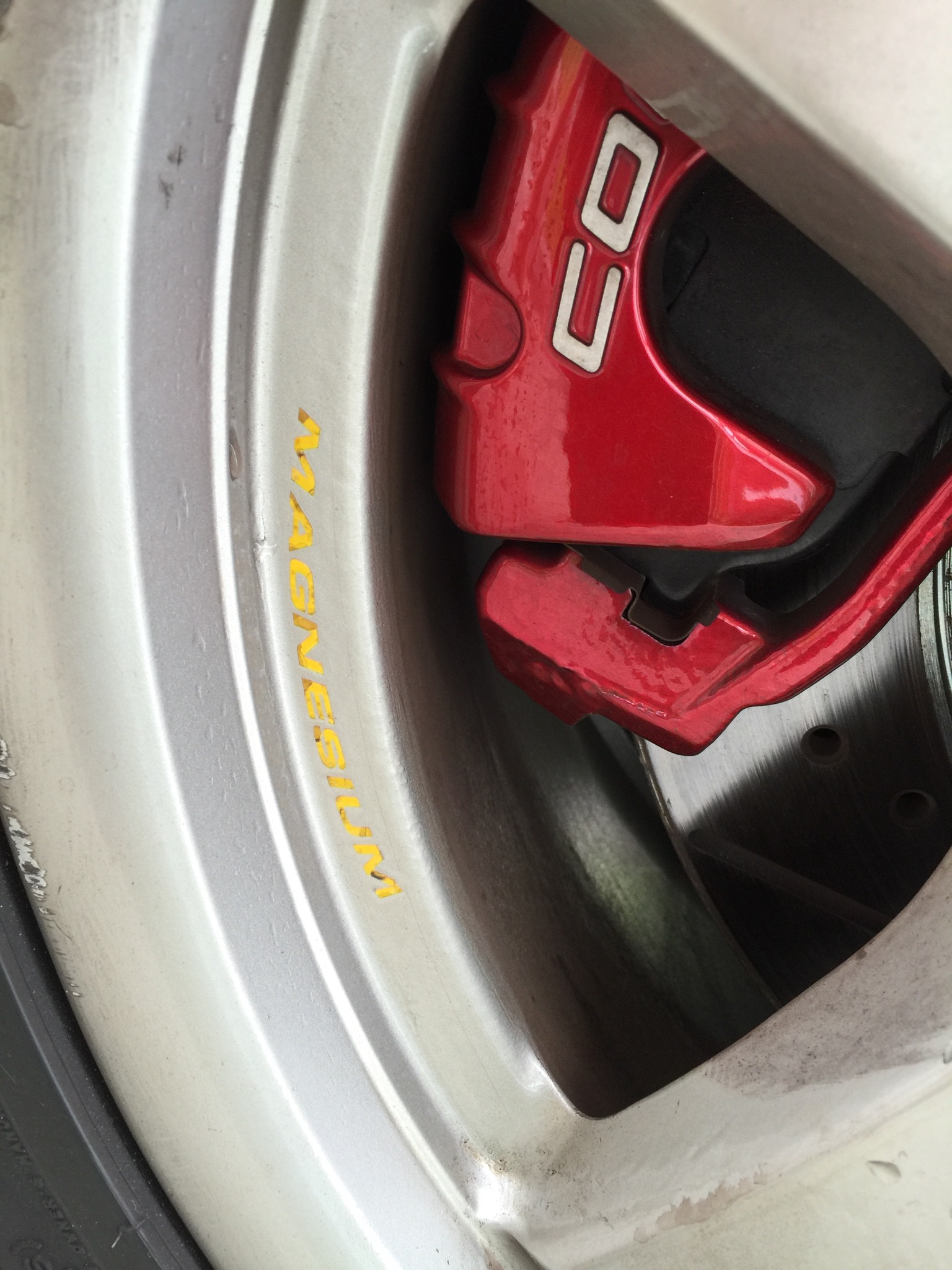

Is there a company that can create stickers, silk screen, etc. that would get this distinctive "magnesium" yellow marking back on my wheel after the powder coating?
I think it's actually a decal that was put on before the clearcoat. Check with a local wheel refinishing shop OR try a decal shop, it should be pretty easy to duplicate. Last I heard (10 years ago) mid-America had them but they've long since been discontinued.
I will check with mid-Arerica, but I do think it is outside of the clear coat as it has come off most of my wheels and has degraded on the remaining wheel.
It DOES sound like putting it under the clear coat would be ideal so that it does not deteriorate with age.
Where would I find a decal shop?

Do a local search on google, etc for "decal shops near me" or similar search. Places that produce vinyl signs etc should be able to do it easy. I'd recommend using Marine grade vinyl (the ones that graphics for boats are used for) as they will withstand abrasion, UV, weather etc much better than interior grade vinyl.
