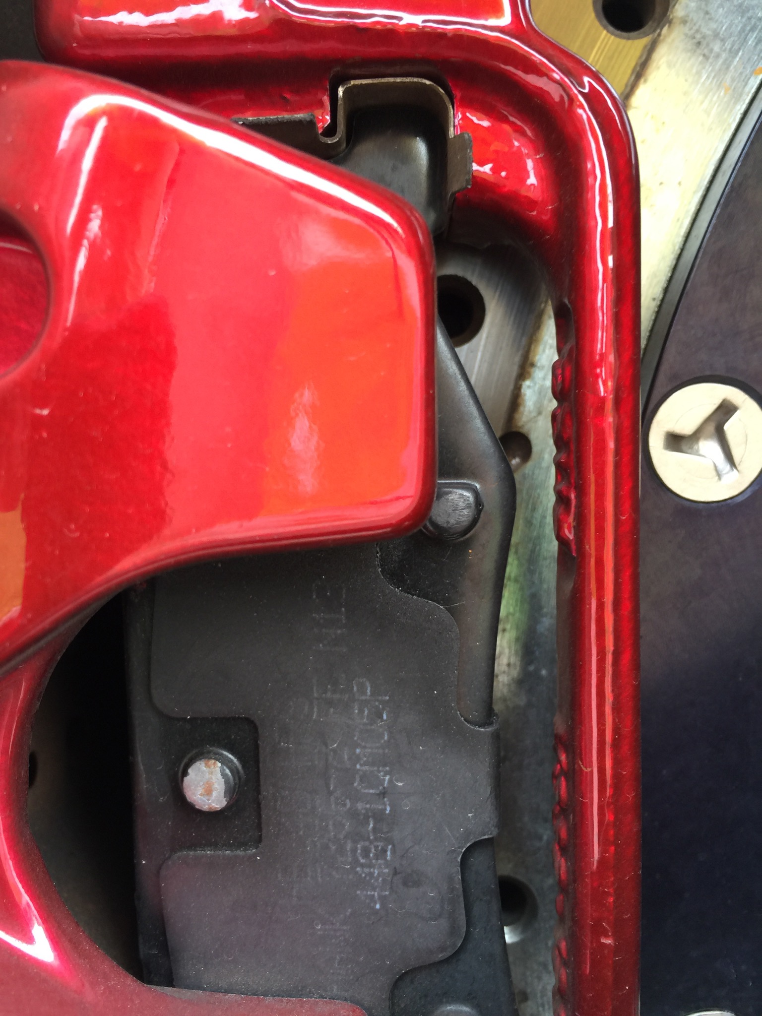

Agreed. The pads actually appear to be reversed in the calipers by the picture. The round edge is usually on the outer edge. I'd get with Baer for sure.
I had thought this was normal, but looking at the front rotors I can see that it is not. Perhaps the pads are reversed as you suggest. Here is another photo where you can see the pads better.
My $0.02 worth.....
I think that your pads are installed "correctly", as the locating ears are seated correctly in the calipers, and the "radius" on the pads' backing plate always faces curvature the rotor's hub, which yours appear to do. However, it might be that you don't have the correct pads.....

I think the pads are correctly installed. I was having such a hard time trying to understand the argument given for them to be reversed that I had to go to take a look at mine...
I don't think the pads are not the right ones either. They fit, in relation to the caliper, exactly like mine.
In my opinion it's the brackets used to relocate the calipers when using Baer Eradispeed +2 rotors. It seems they are taking the calipers too far away from the rear rotors.
