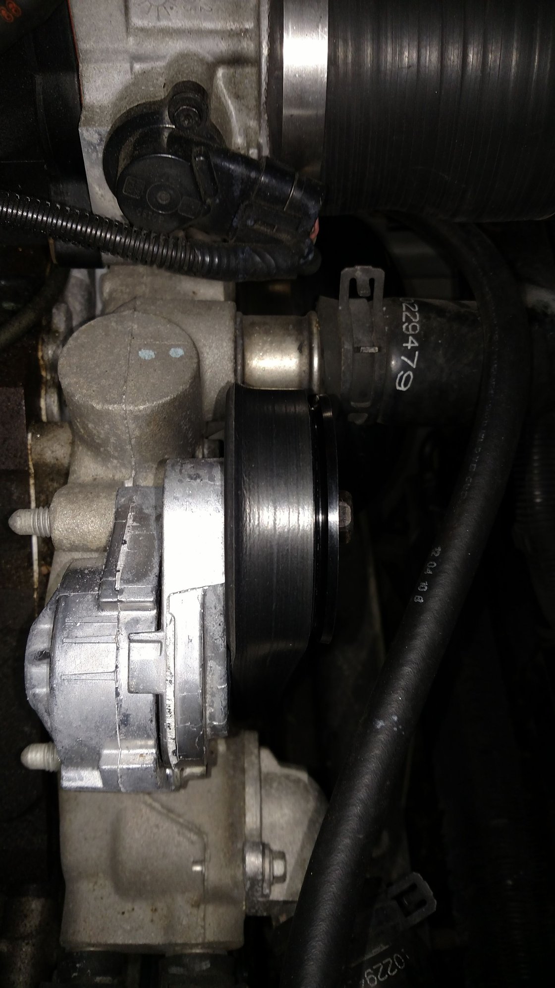

After some research I decided the cause of the chirp was most likely pulley misalignment and the noise was the sound of the belt side hitting the pulley lip. I tested this theory by spraying water and then flipping the belt over which stopped the chirp. I felt all the pulleys and the power steering pump seemed to have a little play in it but no leaks or other noises so I'm not certain that is the problem. I added a video below of both the power steering pump and the HB at idle.
What do you think is the the actual issue? I'm thinking it's the balancer because of the AC tensioner going out again and its a common problem but it looks fine to me in this video? (Sorry for the vertical video)

Hmmmmmmmmm,,,, I watched the Vid 6 times. I really didn't see anything wrong.. What am I missing or suppose to see?
Bill
Old Apr 25, 2016 | 05:48 PM
MGMTF's Avatar
MGMTF
Joined: May 2015
Posts: 50
From: Bel Air MD
Bill
Just supposed to see how the pulleys are spinning. I didn't think there was anything obviously wrong, the small movement of the balancer seemed normal to me.

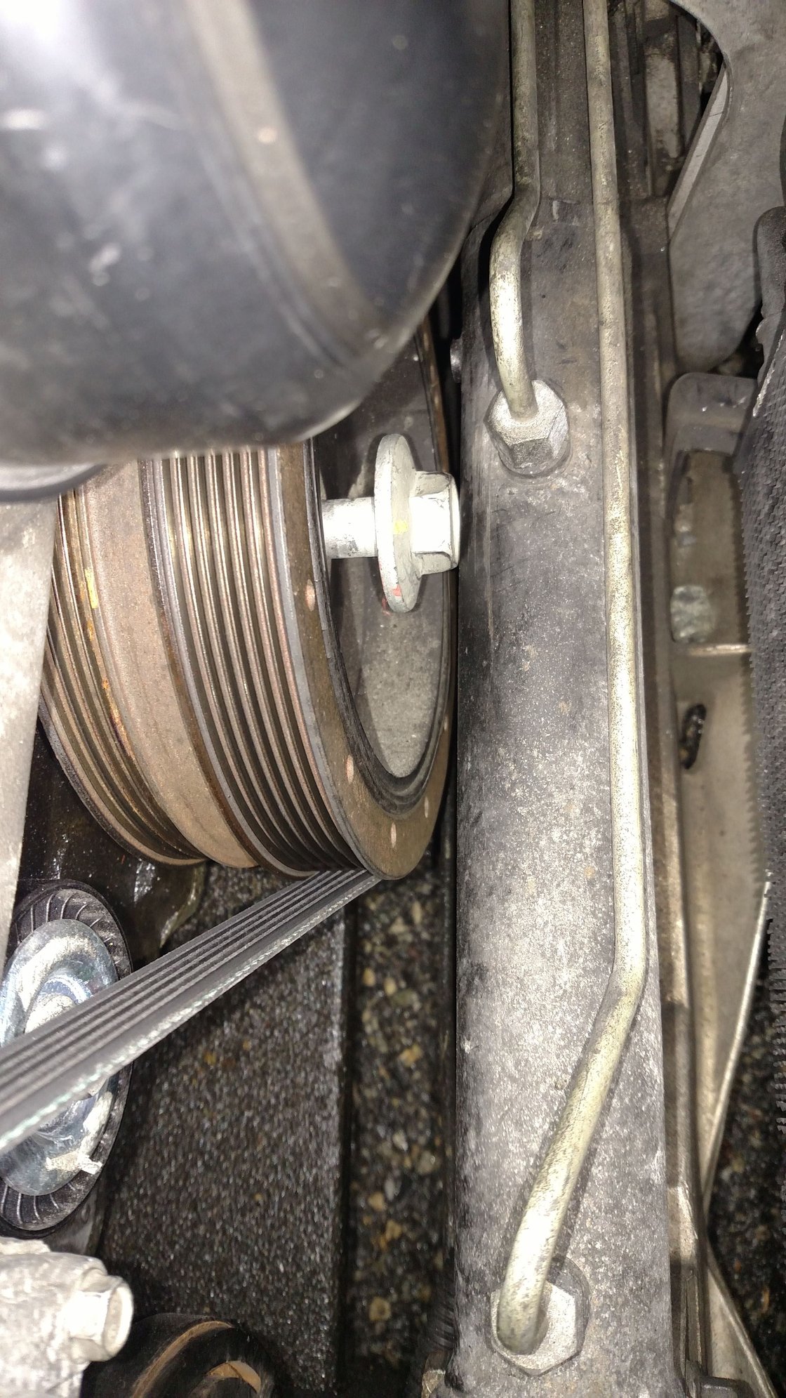

Well new development, I believe this proves it is the balancer. Started the car up tonight to the sound of many noises from the accessory drive to find this. So is the ATI damper worth it? If so, aluminum or steel shell?
Old May 3, 2016 | 02:40 AM
MGMTF's Avatar
MGMTF
Joined: May 2015
Posts: 50
From: Bel Air MD
I discovered the balancer is not coming apart, but rather coming off the end of the crank. I could unthread the bolt completely by band.
