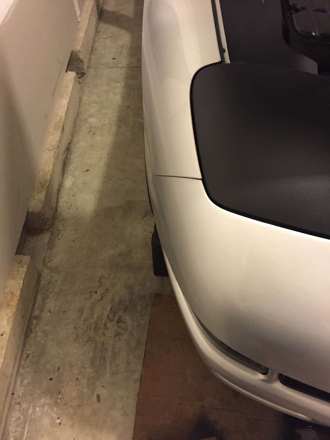

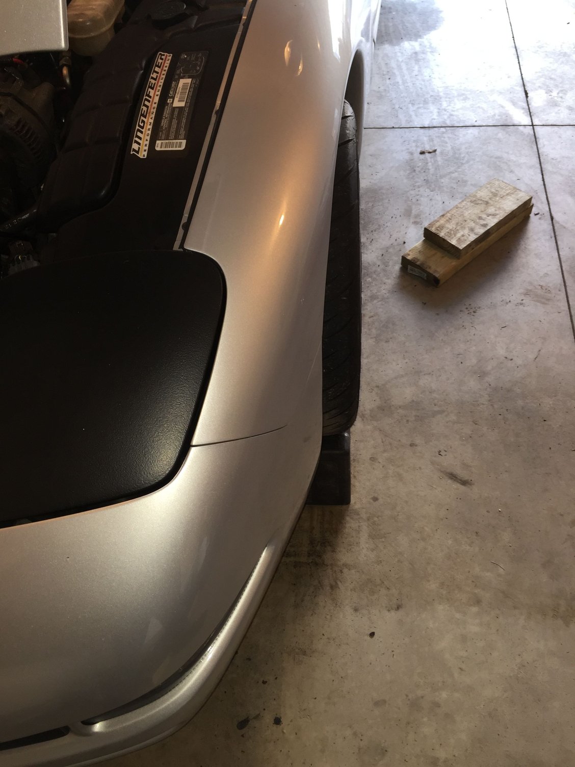

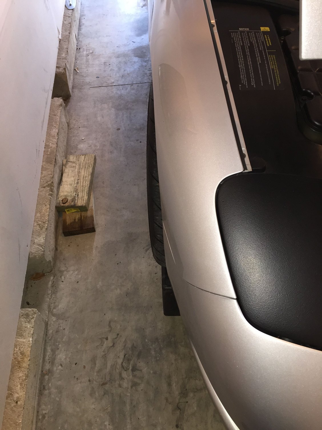

Looking at your pictures, you camber needs to be a little more negative, so move the lower a-arms outward, about 1/8". After that, bring in your tie rod about 1/4" on the left side, and about 3/16" on the right side......this is just a guesstimate, based on the pictures.
However, if your ride height isn't where you want it to be, set that first.

Had a couple mins today and brought one of the
in as well as the toe. Didnt drive it yet and im sure its not perfect but.....
Old May 8, 2016 | 12:28 PM
EnVmYc5's Avatar
EnVmYc5
Joined: Jun 2003
Posts: 479
From: Wilmington DE
Sorry the lca's were adj didn't see the pics split my words

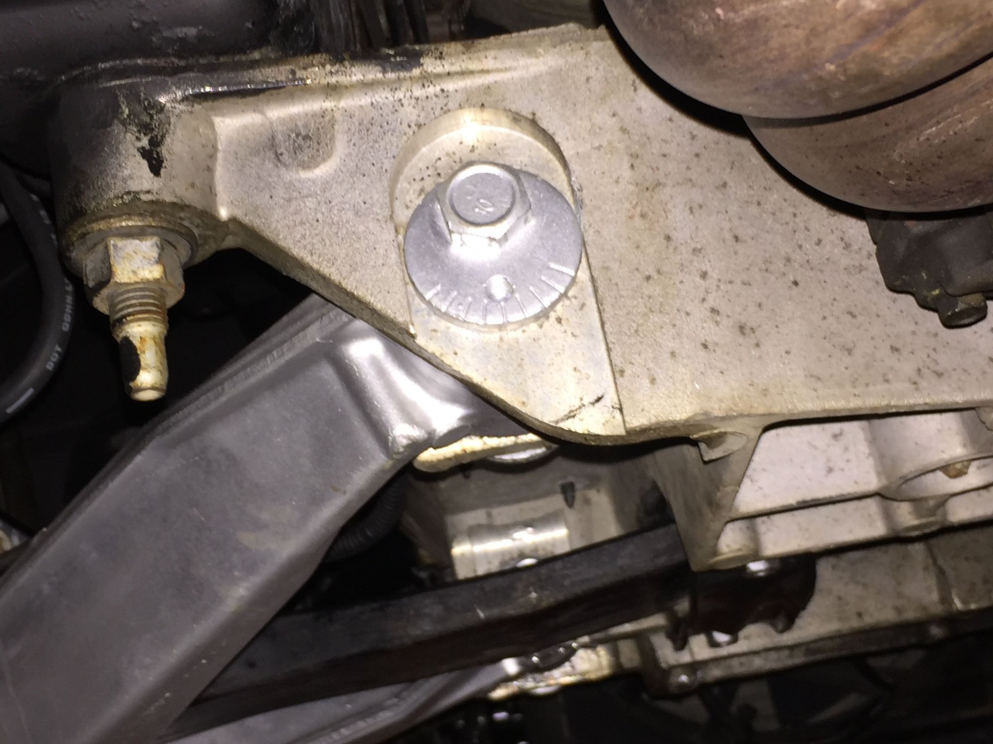

just turn the tie rod ends inward until they look pretty straight. if you want to mess with the eccentrics, then put the bolts at 6 o'clock and adjust toe from there. that'll be close enough to get you to the alignment shop.

Default Just making sure
Mrr23
This is 6 o clock right?
<br >
Old May 11, 2016 | 11:34 AM
mrr23's Avatar
mrr23
Joined: Jul 2004
Posts: 3,092
Likes: 120
From: orlando florida
St. Jude Donor '15
Its fine. But I would put the bolt to the bottom or 6 o'clock position. This puts the eccentric washer inside the groove area in the frame.
