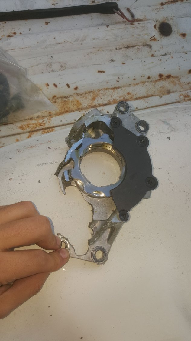

So i need to figure out what is going on with my oil pump. One day my oil pressure was running low and than later my oil pump blew while i was at stop. Towed it to my house took it apart cleaned it out and put in a new oil pump in and it blew again which blew my timing chain and bent my push rods and intake/exhaust valves. I replaced everything got everything fixed put the timing back right and bought a new pump....... started it and blew again and took the timing shain cover with it. Replaced both cleaned it out and cleaned out the oil pick up tube and oil pan to make sure nothing was getting pushed in the pump and yet again the oil pupp blew again i ran out of ideas to what could possibly be the problem. Does anybody have any idea. THE CAR HAS ONLY 49K mile and im running 5w-30 mobile 1

Im at a LOSS. What do you mean that you BLEW THE OIL PUMP OUT?
What evidence do you have that the oil pumps are BLOWN?
Can you take pictures of the damaged pumps. What do you see in them that's failing?

The pump is in pieces literally blown

Those are the first 2 pumps the third one i didnt take a picturee of them

Well I guess that the PUMPS have really been blowing up.
What pressures were you seeing at the first start of each new pump??
The only thing that would cause that is the pump being dead headed and the pressure relief valve not functioning.
Here is the oiling path for the C5 LS engine:
Pull off the oil filter adapter on the side of the block and see if there is anything in there that blocking the flow out of the pump!

In the pump that is still in some what of one piece,,,, examine the pressure relief valve and see if it is able to be moved by hand or is it not able to move.
It should have relieved WELL before that much pressure was generated!
You should also be able to BLOW COMPRESSED air into the oil supply hole in the front of the block and it should be able to come out of the pipe that the oil filter screws on to. Before you take the oil filter adaptor off the block, give that a try and see if you get air flow out of the center oil filter pipe.
