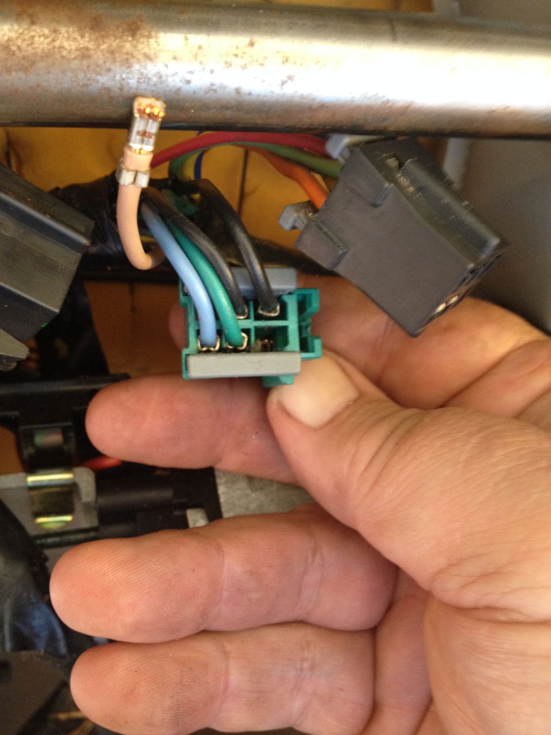

I think I found the problem<br/>
Tan wire broken

Yep that was it, one more thing checked off the list.
