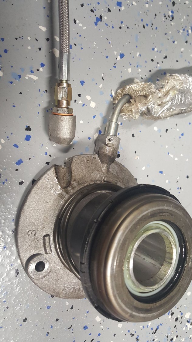

I'm about ready to push it off a cliff or light it on fire. Oh wait it dosnt roll and I don't want to burn my house down ****.
I got it to about 1/4 of an inch away so I figured it was in the pilot (not damaged) and used a bolt to pull it in. This was by hand mind you and it didn't take hardly any force at all. Then I head a pop... hooked up clutch line and it poured fluid. The quick time bellhousing has almost no clearance for the TOB. That is what caught the last 1/4 inch. So time to buy another new one. If that one dosnt Go in I'm going to grind the bell.

You're putting it into a quicktime bellhousing I see your struggle .
A good friend of mines cousin had a similar issue with a 98 c5 procharged, he tried all types of ways to install it, it wouldnt go in. He ended up taking off the quick time and test fitting it on the torque tube while out of car and found it was slightly off. He sent it back and got another one then installed and it went right in. Aftermarket housings sometimes have many different variations. I would take it off and test fit it, that way you're are'nt pulling out your hair, also wouldn't hurt to have a couple ice cold beers on hand.
