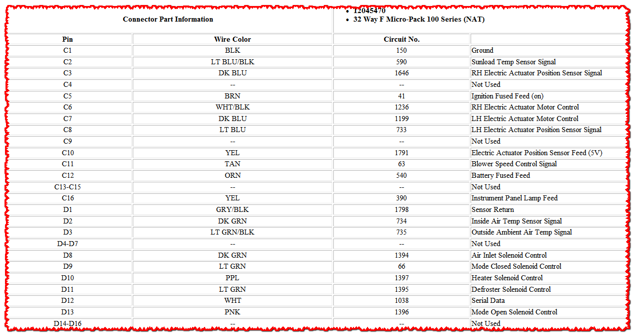

Wanted to test a climate control I have here, is there a way to test on bench? I have a cut off plug I can use, just need to know which wires to power up. Thanks

I hope this may help , it for a 2000 mod.
To C5 climate control wiring bench test?
