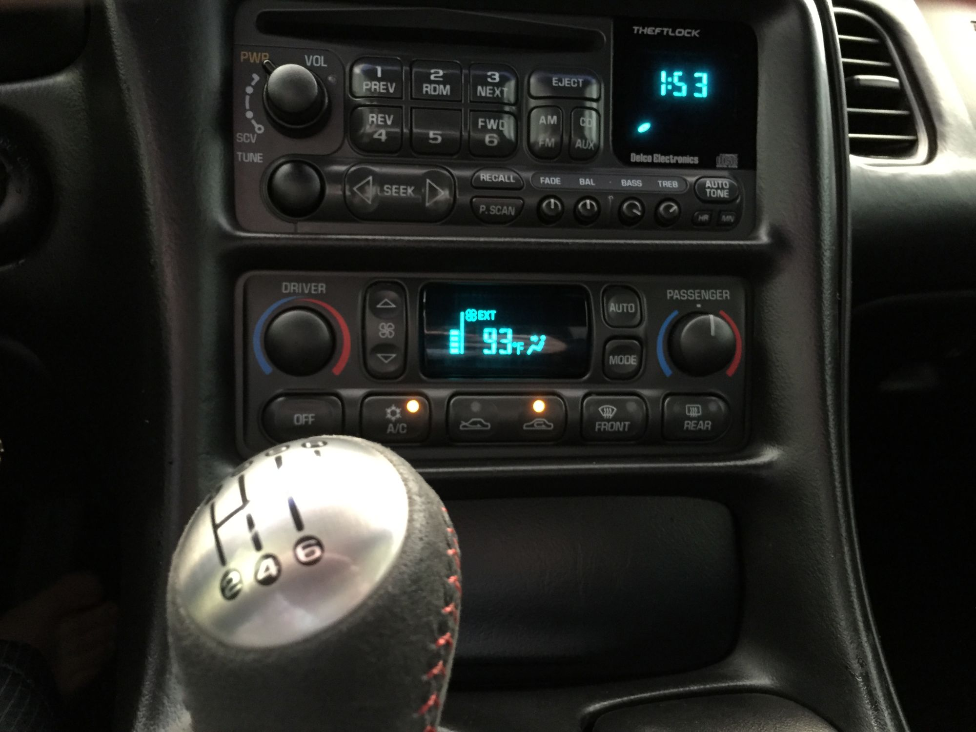

Here is a pic encase someone doesn't understand what im talking about. Everything works just the back lighting.

Sorry... your radio back lighting is also out/off?

In that pic yes. But it still works. Didn't have the lights on in that pic. Its just the HVAC.
