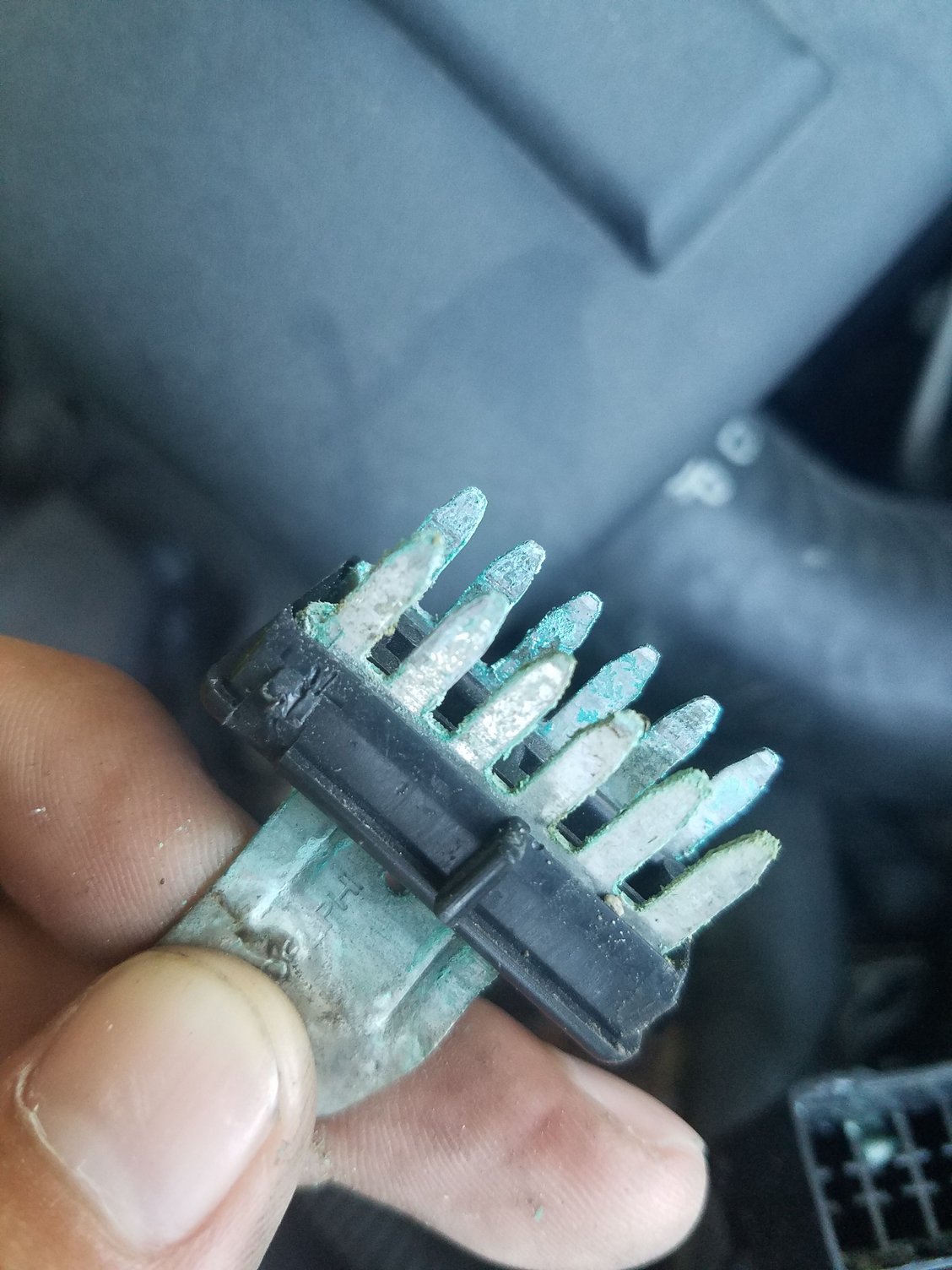

Thanks to searching the topic on here and helpful posts by Bill I started checking all my connections. Found this wonderful ground connection and no more lights no more codes as of yet. Thank you to the guys that help us keep our ladies goin.

LOL! Man,,,, I've seen something just like that before. Good find!
That said,,, The 1214 DTC usually isn't the result of a dirty ground but, if its compromised bad enough the RELAY inside the EBTCM was most likely running under voltage and that could have been causing the 1214 DTC.
Keep an eye on the issue and if it returns, you should remove the module and repair the relay that causes this issue or repair the printed circuit solder joints that are sometimes cracked. If you don't do circuit repairs, send it to ABS FIXER.

Hey I went from a constant active handling and abs light to no lights and no codes so I'm chalking it up as a win for now. I will be in touch with ABS if I have any other issues out of it. I do electronics/robotics/plc wiring and programming all day but I'll send my stuff off and let someone else do it properly. Thanks again bill

Wow, was the car flood damaged?

No.. I guess the previous owner drove in the rain alot?!
