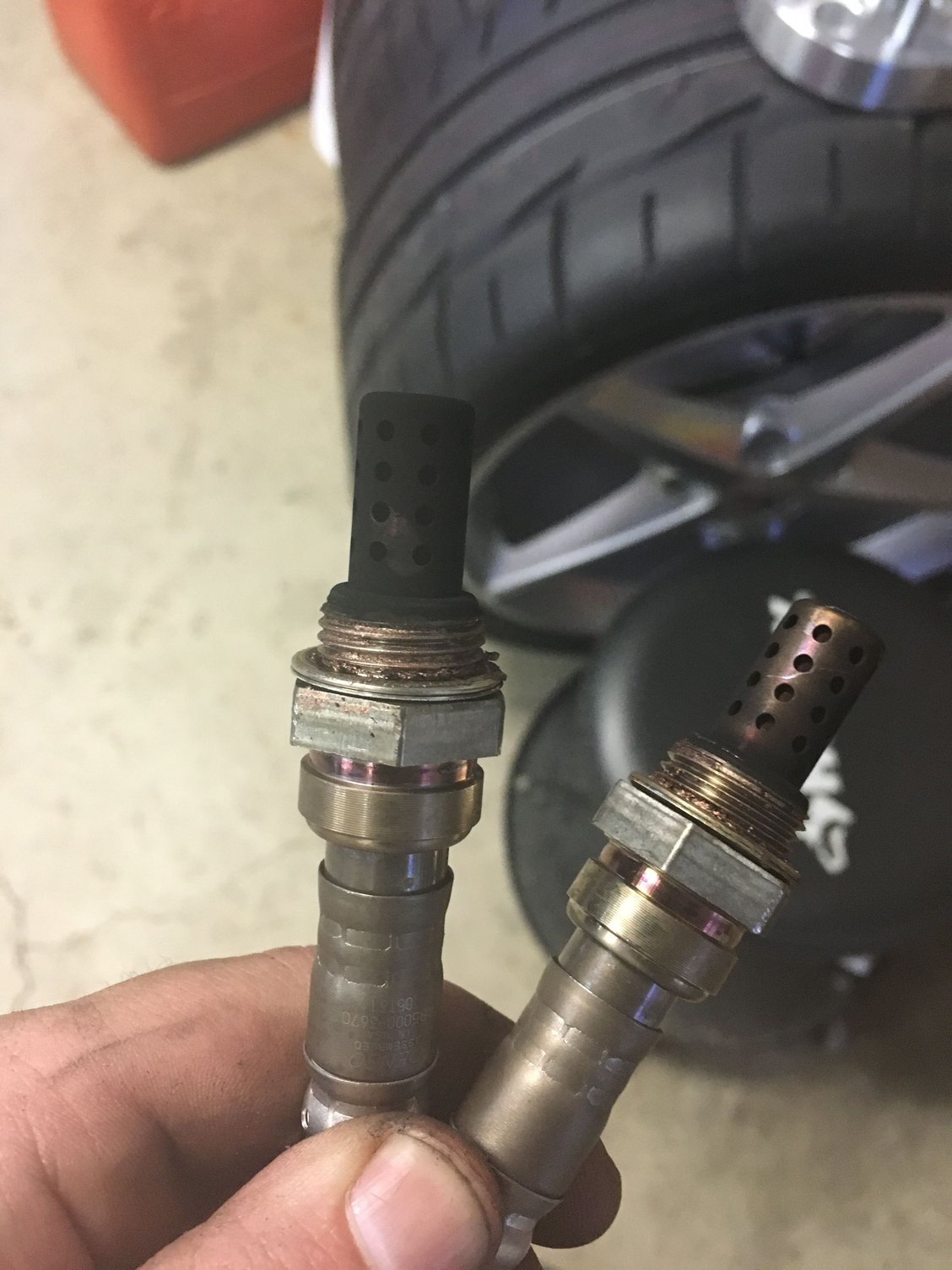

Looks like one of the "new" sensors was bad.

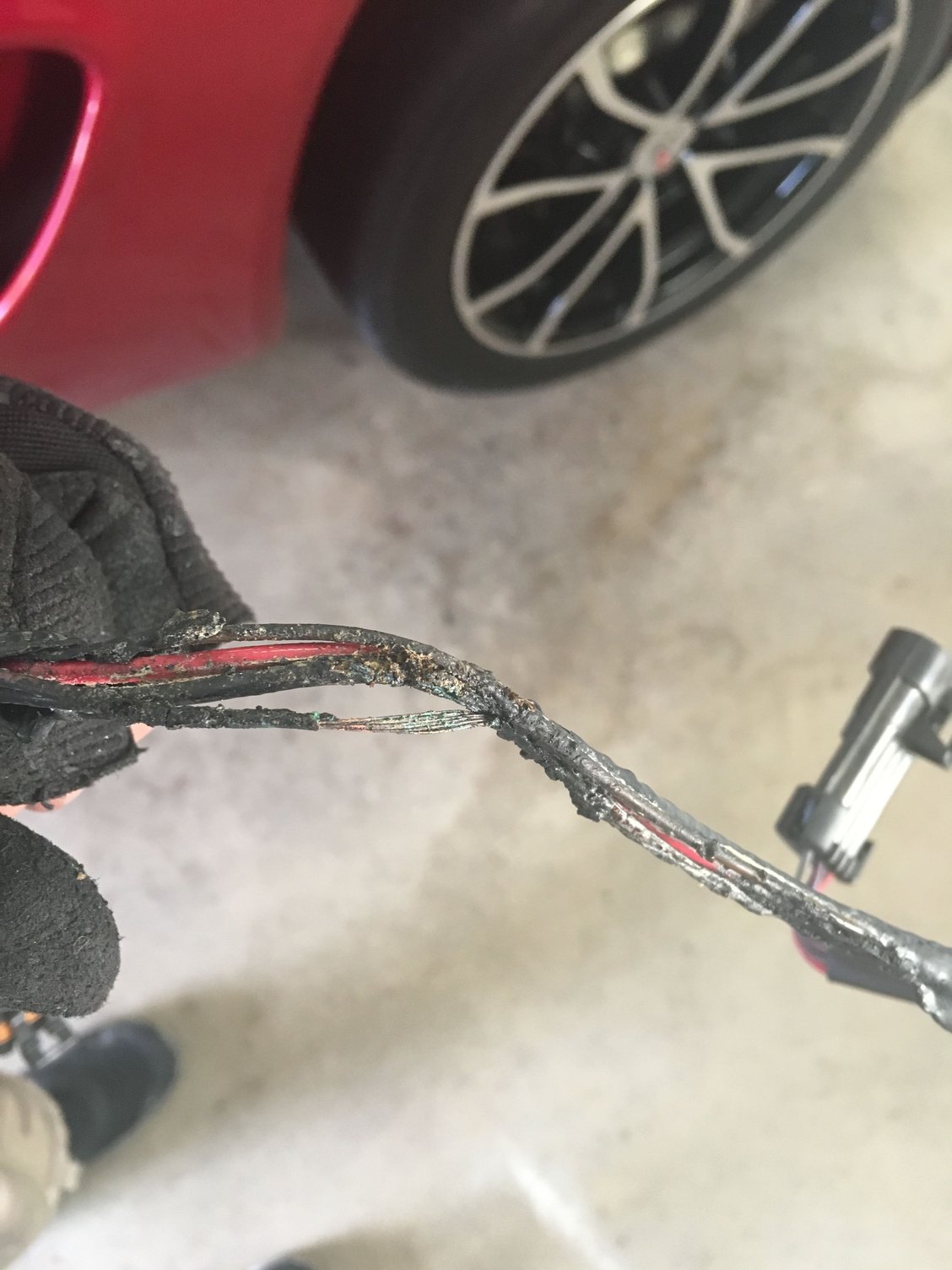

Wasn't the sensor
Old Aug 12, 2016 | 10:33 AM
Black 02's Avatar
Black 02
Joined: Apr 2011
Posts: 4,260
Likes: 429
From: Houston TX
That'll do it. Did it get up against the exhaust?
To O2 sensor install now rough idle and surging
Old Aug 12, 2016 | 10:46 AM
01badvette's Avatar
01badvette
Joined: Jan 2016
Posts: 307
Likes: 31
From: Upstate New York
Yea the LT headers there's some pinch spots. When I moved it around to install the new sensors must have finally broke it thru

...Glad to see that you found the problem, now, is the car running normal !!...

Car is back to running normal, a quick hour job turned into a 2 day headache but it happens sometimes.
