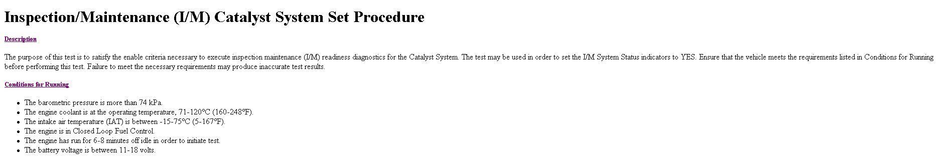

FYI, clearing codes will clear the emissions monitors. A low battery or battery connection problems could also cause the monitors to reset.
Here is the Corvette specific info for each monitor you're having trouble with. I see no reason the catalyst won't set if you've driven it off idle for enough time. But, the EVAP could be troublesome in very hot weather.

Although it is too late to help you, I stumbled across a GM emissions drive cycle as shown below.
