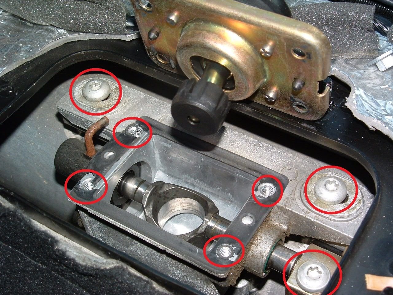

Anyone here knows the torque value (ft/lbs or nm) of these bolts? I have to re-install oem shifter.

The three T-40 Torx bolts get 22 lbft. Do NOT overtorque.

Any idea what the torque specs are on the four bolts that hold the shifter to the lower box?
I doubt there ARE any. TTBOMK, never available as a separate item from GM, so no need for a "spec".
If I were to guess, I'd say likely in the 5-8 lbft range.

Sorry to hijack the thread but since it relates to the picture in this post I'm calling fair game.
So I took apart the shifter so I can lube it (bushings are shot so those are on order) and the gasket between the upper and lower sections got torn up. What has everyone else done in this situation? I know some aftermarket shifters come with a new gasket. Do I just buy a gasket material from the auto store, run without the gasket, or use a bead of silicone? From what I got from a youtube video is that the gasket is merely for vibrations. Any suggestions?

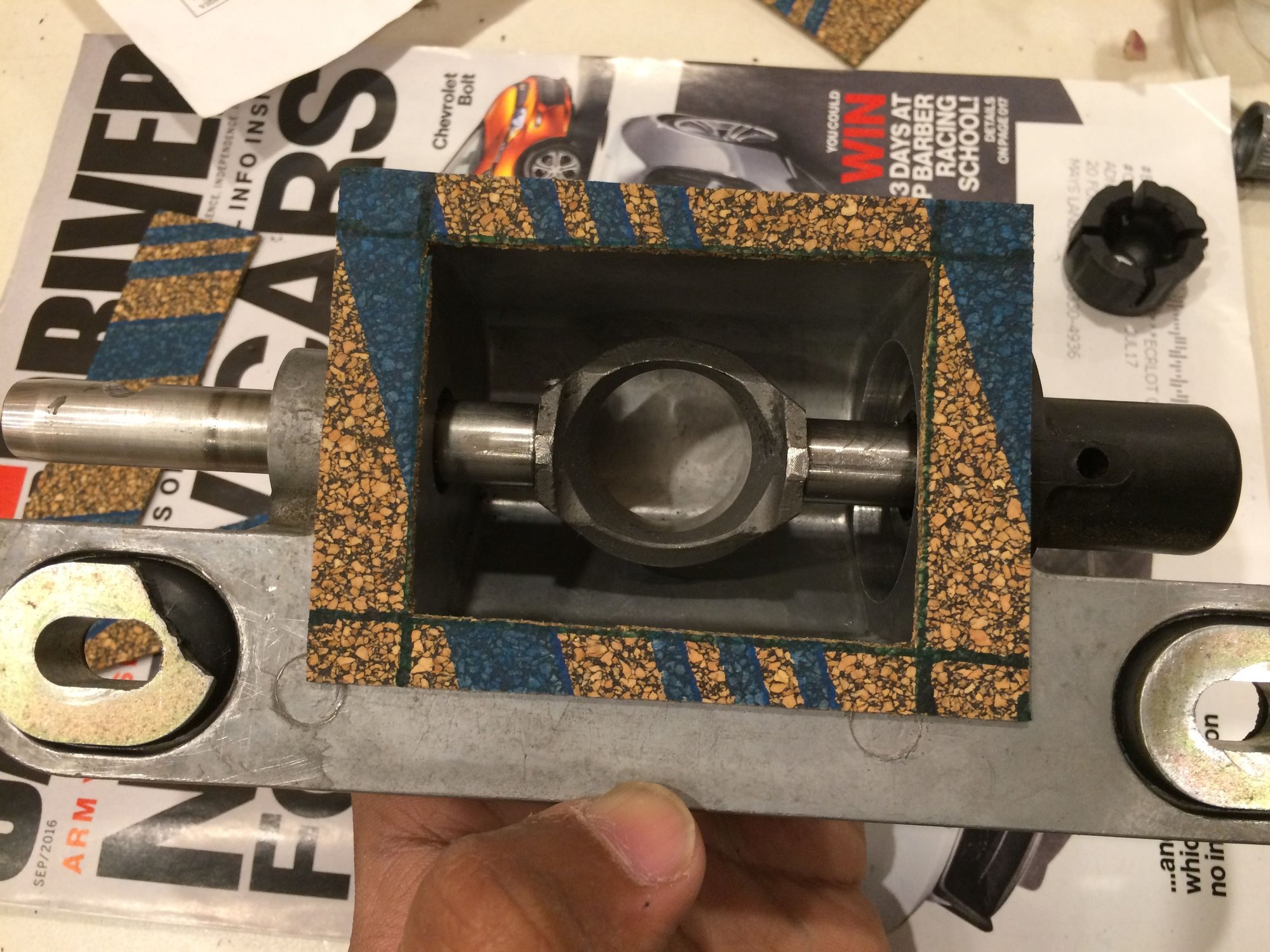

You're correct. Yeah the GM one is so fragile ( I heard). I just cut my own gasket piece from gasket maker sheet.
