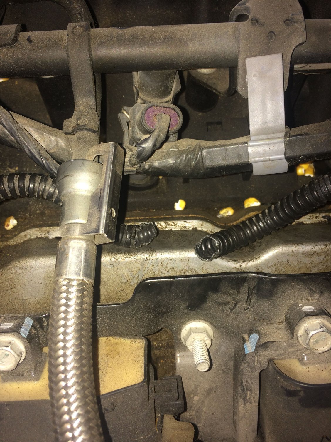

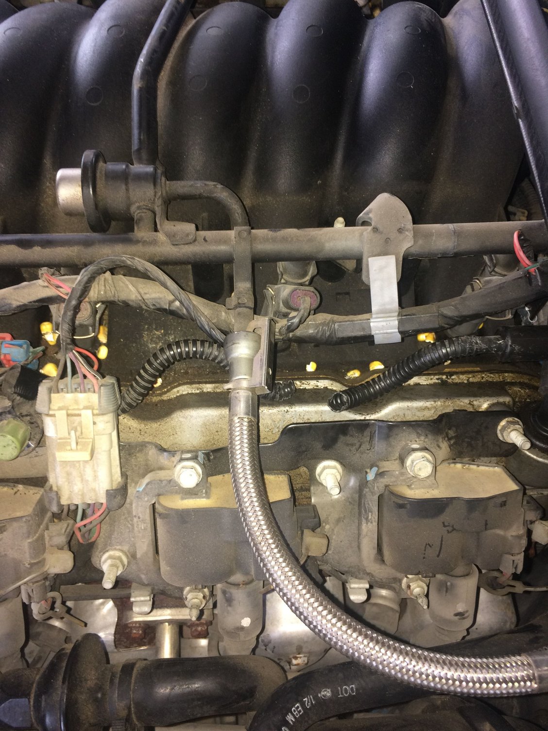

See the corn? Damn mice!!
So I just now noticed this. Drivers side. I'm assuming it's some sort of vacuum line. Stupid mice must have chewed it through.
What is this little hose for, and do you think that's the root cause of the problem?
Old Sep 16, 2016 | 06:38 PM
jjaaam's Avatar
jjaaam
Joined: Aug 2014
Posts: 717
Likes: 80
From: Michigan
Started it up and put my thumb over the broken end that is towards the front of the car. Felt vacuum pulsating. And the minute I did that the helicopter sound stopped.
This line has a small green plastic **** on it that says "hand tighten only". Is this one of the AIR check valves? It looks like an entire hose assembly going from the front to the rear of the engine.
I can't seem to find a picture of it online so I can order another one.
Any ideas what it's called? Safe to drive?

Old Sep 16, 2016 | 06:48 PM
Smoken1's Avatar
Smoken1
Joined: Apr 2013
Posts: 5,035
Likes: 1,156
From: Oregon
Marc at vettenuts.net give them a call. All that stuff I had hit he trash can since I have no smog laws up here

Old Sep 16, 2016 | 06:55 PM
jjaaam's Avatar
jjaaam
Joined: Aug 2014
Posts: 717
Likes: 80
From: Michigan
What is it called?
Old Sep 16, 2016 | 07:11 PM
Smoken1's Avatar
Smoken1
Joined: Apr 2013
Posts: 5,035
Likes: 1,156
From: Oregon
I can't find it online. Call them I have seen other posts like this and Marc knows. Just call and explain or email him the picture
Old Sep 16, 2016 | 09:55 PM
jjaaam's Avatar
jjaaam
Joined: Aug 2014
Posts: 717
Likes: 80
From: Michigan
Got the answer here:
https://www.corvetteforum.com/forums...post1593074023
Thanks to neutron82 for the help!
