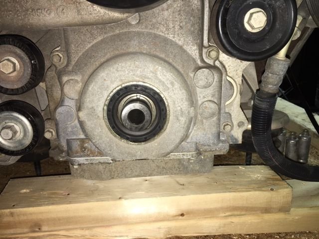

Front main seal

thought I would post main seals separately. Existing seals were not leaking at all but, with 73k mi. decided to go ahead and change since it will never get easier than this.
Both seals from GM dealer. Front seal was a cinch in and out. Front replacement seal snapped in evenly with strong thumb pressure. Verified with light tap w/dead blow mallet and tool.
