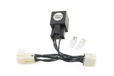

A hyperflash harness should fix your problem and, as an added bonus, will allow you to install LEDs in the future with no hyperflashing.
This one even includes 2 LEDs for you license plate lights for just $34.99. It's completely plug-and-play: no splicing or anything

The hazard switch also controls the turn signal function, although in separate sections, so you could have problems with the turn signals while not having them with the hazards. This is a well documented issue.
You could replace the hazard switch or you could insert a hyperflashing harness as I suggested above. A hyperflash harness will only take over the turn signal portion of the switch and will give you the benefit of being LED-ready. It is also a much simpler installation

Does that harness plug into where the hazard switch is or what?

You just need to remove the driver's side knee bolster. The harness gets inserted at a connector by the right side of the steering column.
