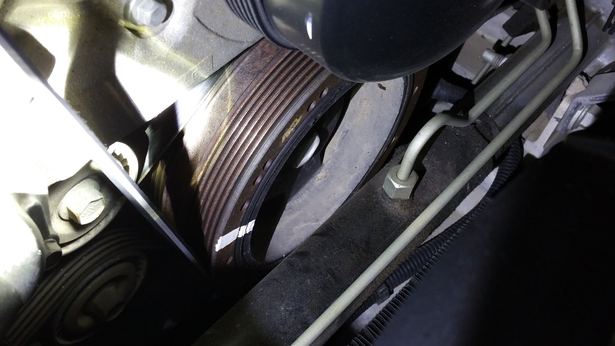

Bill Curlee and 8Vette7 gave me this advice: As long as there is no visible wobble of the actual metal parts of the HB as the engine runs it is fine. Paint a white stripe on the front of the outer ring damper and across the elastic to the inner ring. If the outer ring ever moves you will see it easily.

I just bought a 1998 Corvette a little over a month ago and just checked out my pulleys and belts to diagnose a chirping issue. I believe I see a wobble in the HB, but do not know if it is within the normal range. Here are some details of my situation:
- Car only has 32,000 miles
- Prior owner had the belts changed a little over a year ago by the dealer (along with other service work like flushing/replacing all the fluids, to the tune of about $1,300 of minor preventative maintenance)
- When I spray water on the belt, chirping stops
- I don’t hear any other noise when the chirping stops
- The chirping only lasts about 5 minutes (it seems to completely go away after it warms up)
- I only drive the car for fun and cruising, I don’t drive it hard (I’m guessing I will only drive it a few thousand miles per year if that)
Should I be concerned? Or just keep an eye on it?

I have had to changed two balancers on my C5. I first replaced with a stock GM replacement. I ran it about 1500 miles and it started chirping and I checked and it was coming apart. I then replaced with a Power Bond stock replacement and now have about 8000 miles and not a problem.
If it was mine I would make sure it was not the A/C belt and the drive belt for sure. I would get a Continental elite new main belt that used to be the Gator Grip belt and install it and just watch the balancer. Mileage does not always mean that the balancer is not wobbling. Good luck

Had the stock balancer fail in my '99 without any of the warning signs, replaced with a Powerbond myself. It had less than 25,000 miles but that rubber was almost 18 years old.
Did the paint stripe on my '03 and I check it regularly.

What do you think about my chirping stopping after the car warming up after about 5 minutes of driving, Even when I get back home and just let it idle, I don’t hear any noise?
Thanks, I’ll try the paint trick. Thanks for the photo, that helped a lot. I saw another post that used white shoe polish, and it was pretty much a mess.
