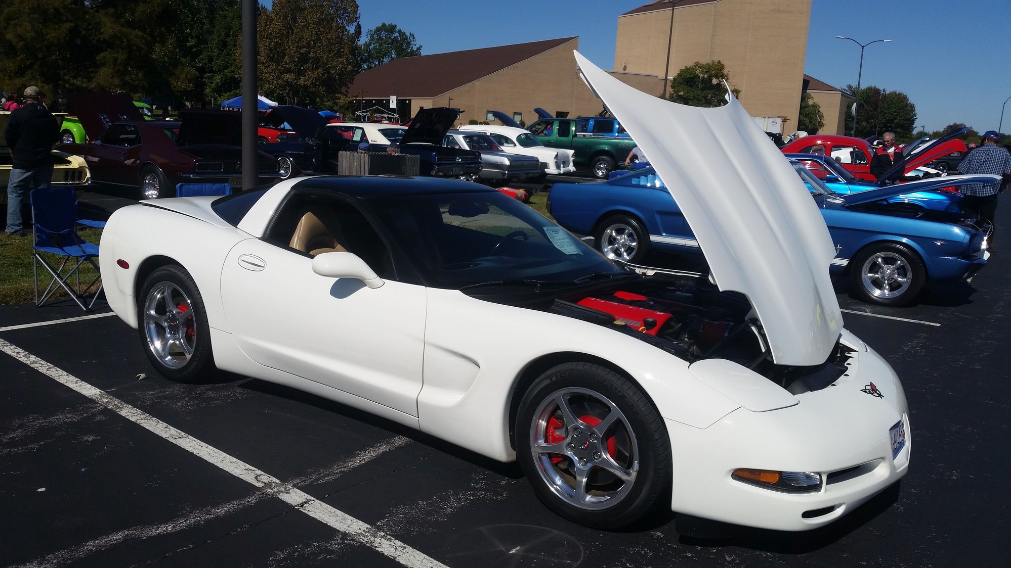

How do you like your white Vette?

I love the color and the car has been a great vehicle for the last three years.
