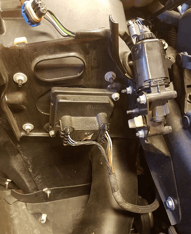

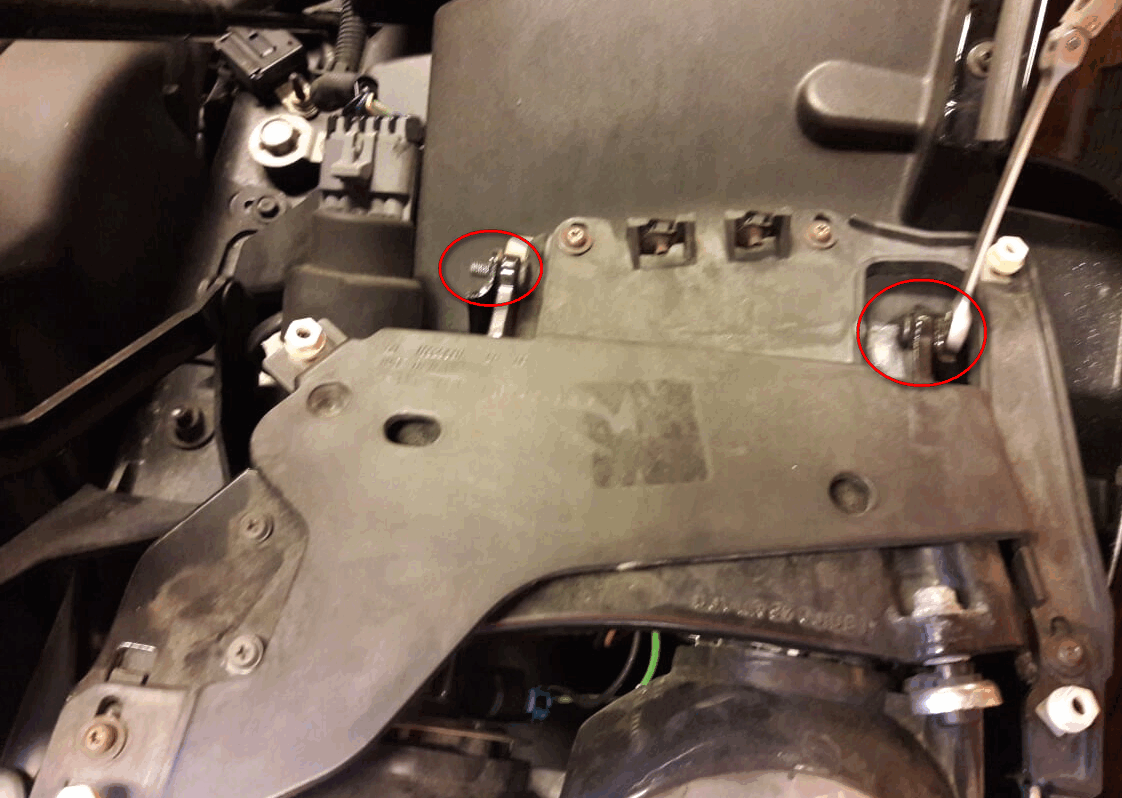

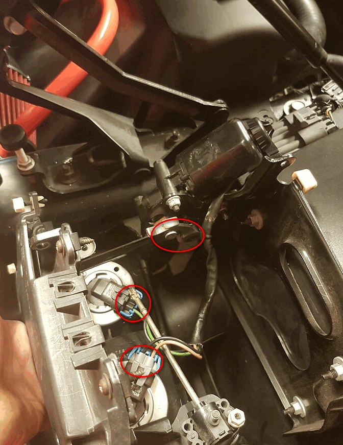

I upgraded my FOG lights to HID a few weeks ago and took som pictures . I did not remove anything from below .
I took off the bezel around the headlight first , the I removed the two small bolts the headlight mounted with .
Then I disconnected the two plugs on the lamps and removed the 10mm nut on the linkage arm(on the motor) . After this I put the headlight aside and the Headlight module is in front of you , as shown on the picture below . The headlight module is on passenger side , but the two first images is the driverside headlight because I did no take those photes on the passenger side .
Hope this info helps
Thks a ton. Gonna give it a try.

Hey Oelarse,
Thanks so much for the directions and photos. I'll try to save the pics and directions to the computer so I can refer to it while I'm working on it...doesn't look that difficult.
Thanks again.
