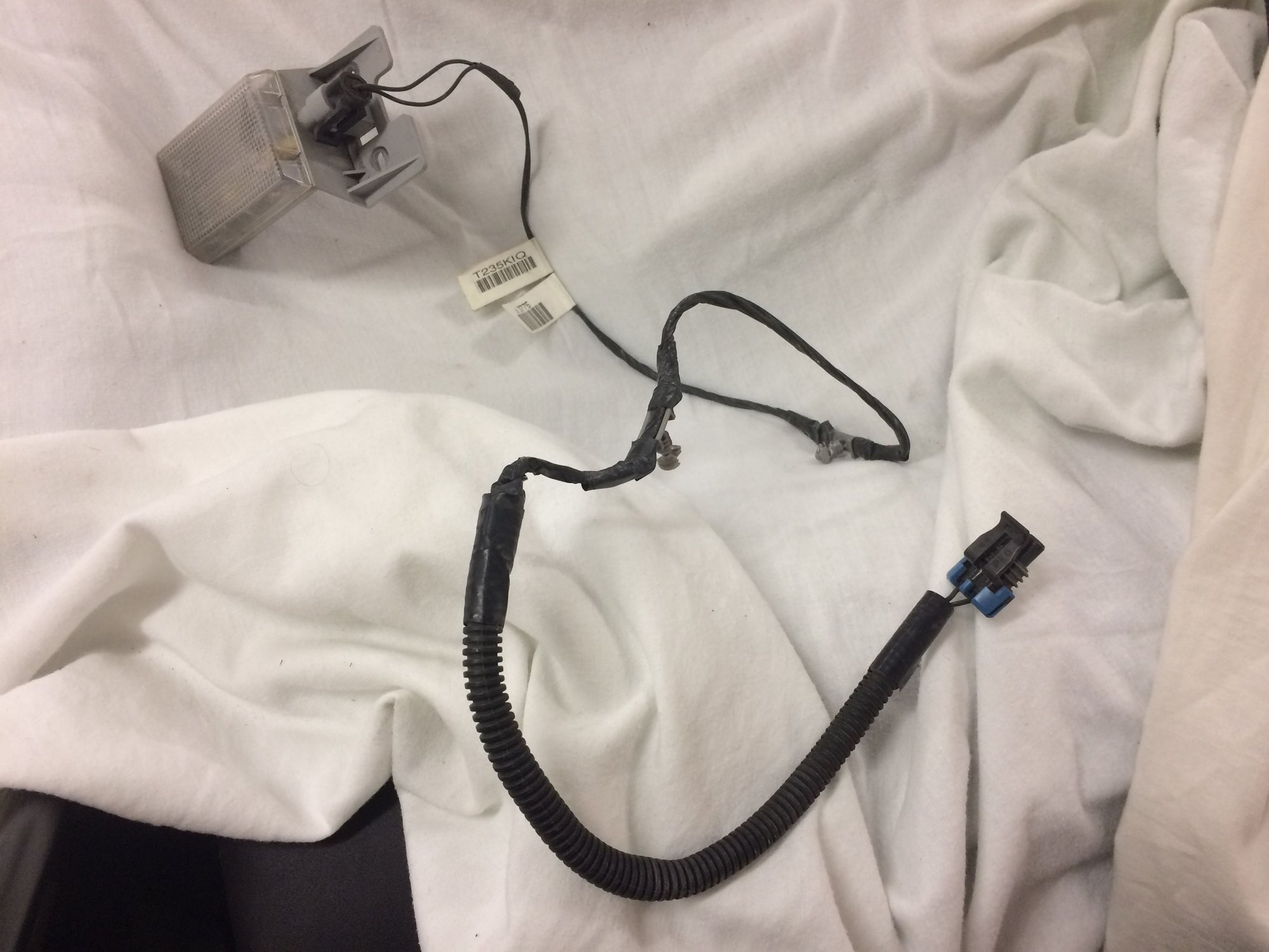

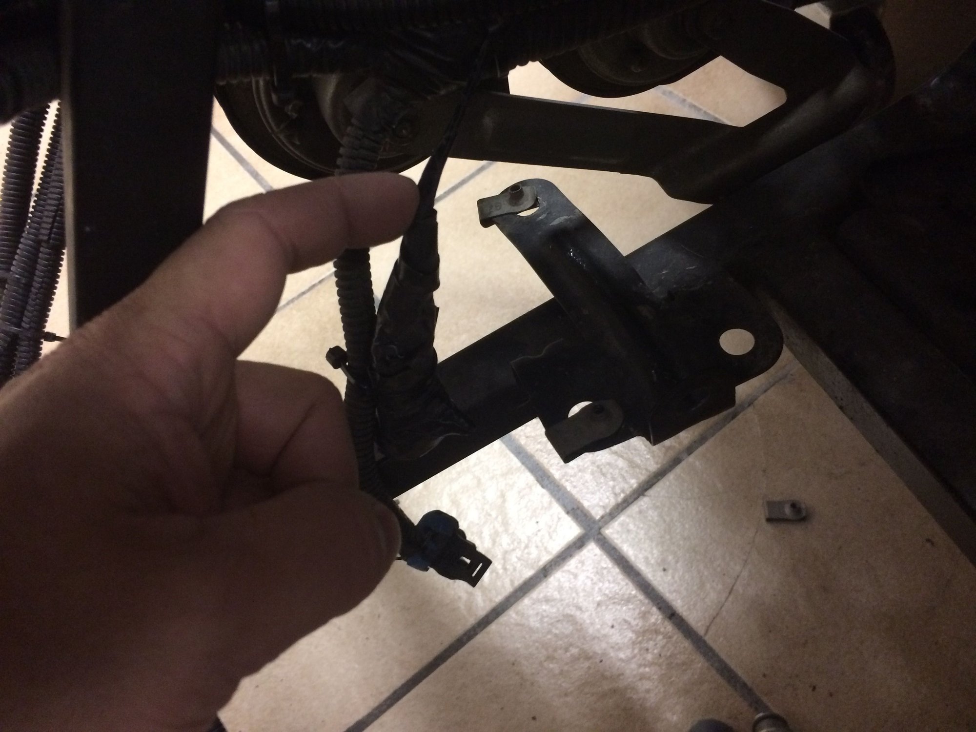

As 8vette7 says, the female connector is located in the passenger side, and it comes free of the harness right at the horn assembly (unless you´ve relocated the horns when installing the A&A kit):
I´ve wrapped the connector and fastened it with zip-tie´s to the other wires, as I went another route:

Thanks for the pics. Good to know where those wires to the hood light come from.

A picture is worth a thousand words. Thanks I will check. Currently I am knee deep in both the HUD fix and the climate control display fix so the vette is in a hundred pieces. As soon as I'm done I get it up on the race ramps and give it a look. Thanks again.
