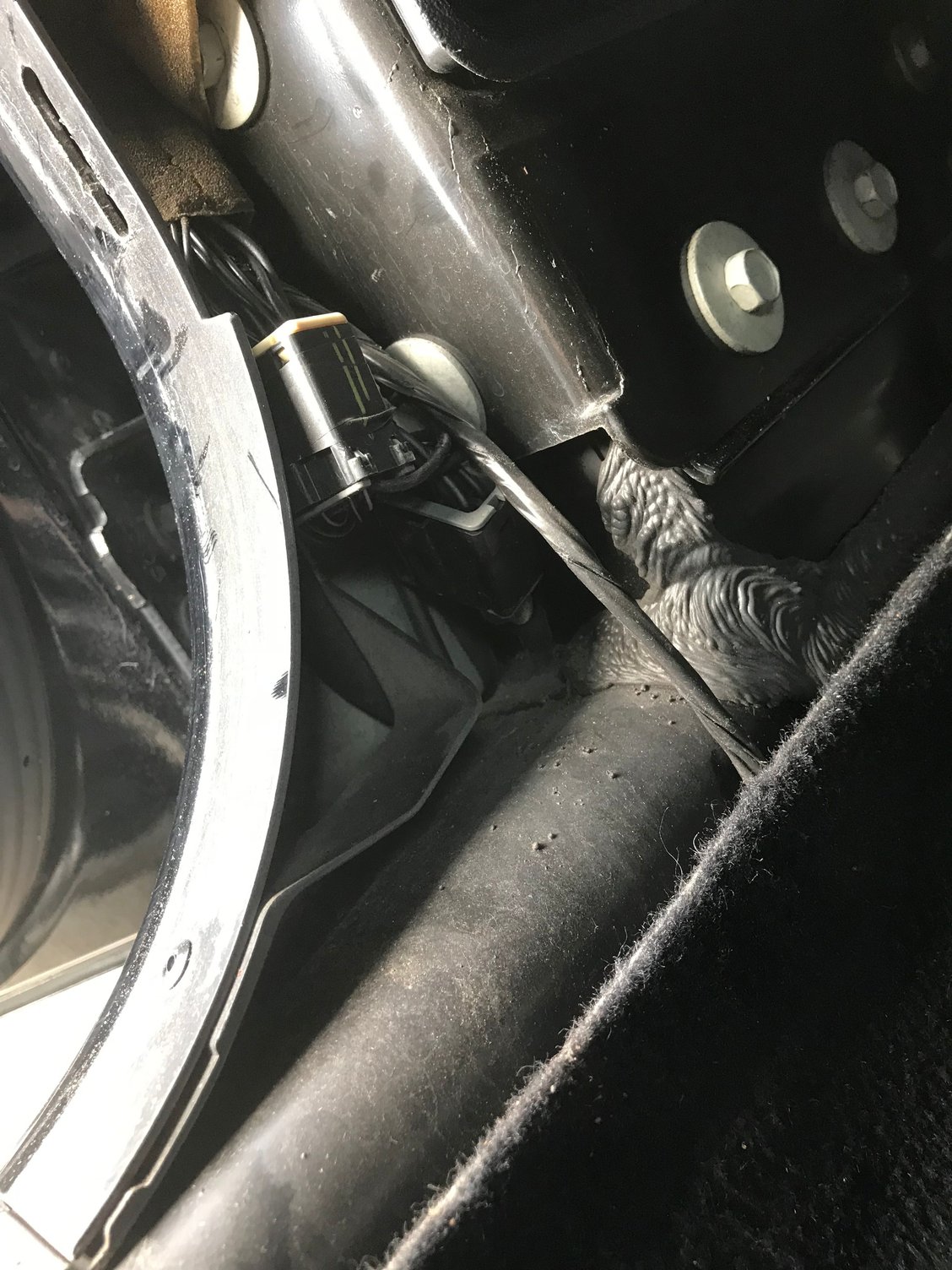

Close up of the G-202 Ground:

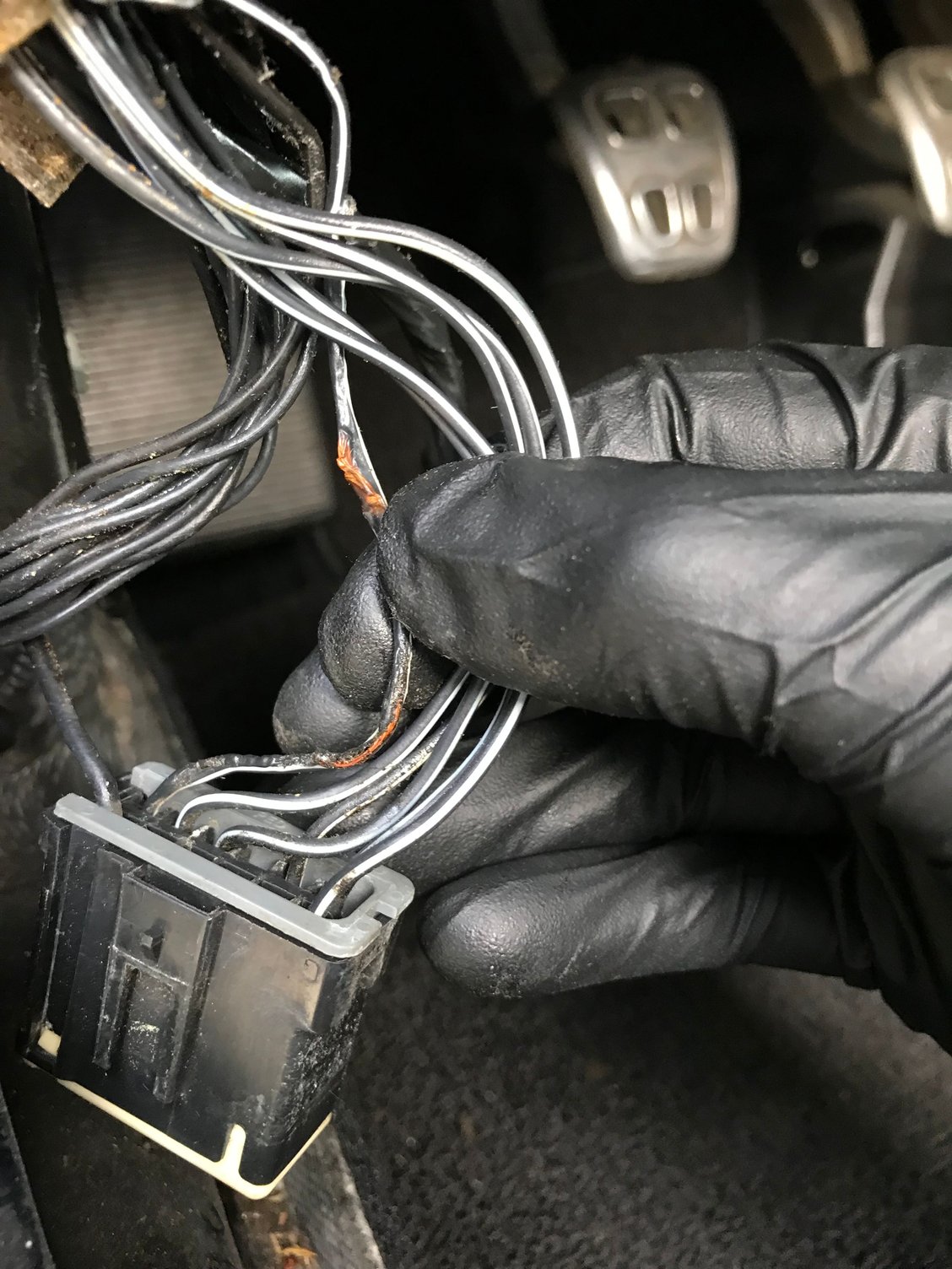

This crimp is our first issue.

That connector is NOT your issue. That clear plastic tubing is nothing more than a SPEAKER SHIELD and has nothing to do with the issue. That plug is a signal connector and has wires for low voltage signal wires.
The POWER CONNECTOR is what you need to be concerned with
BC

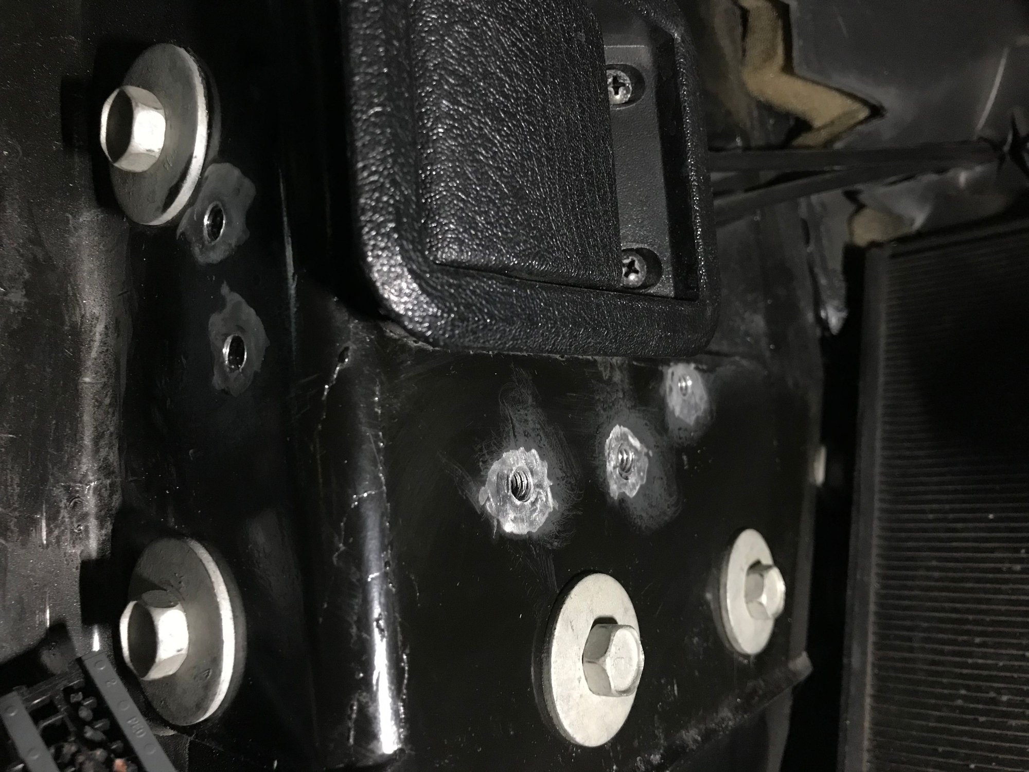

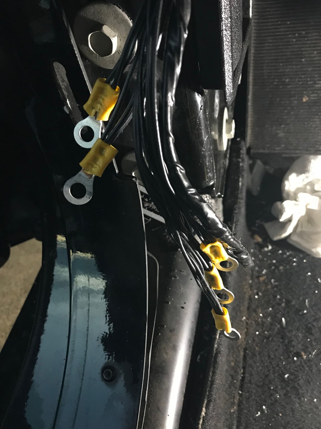

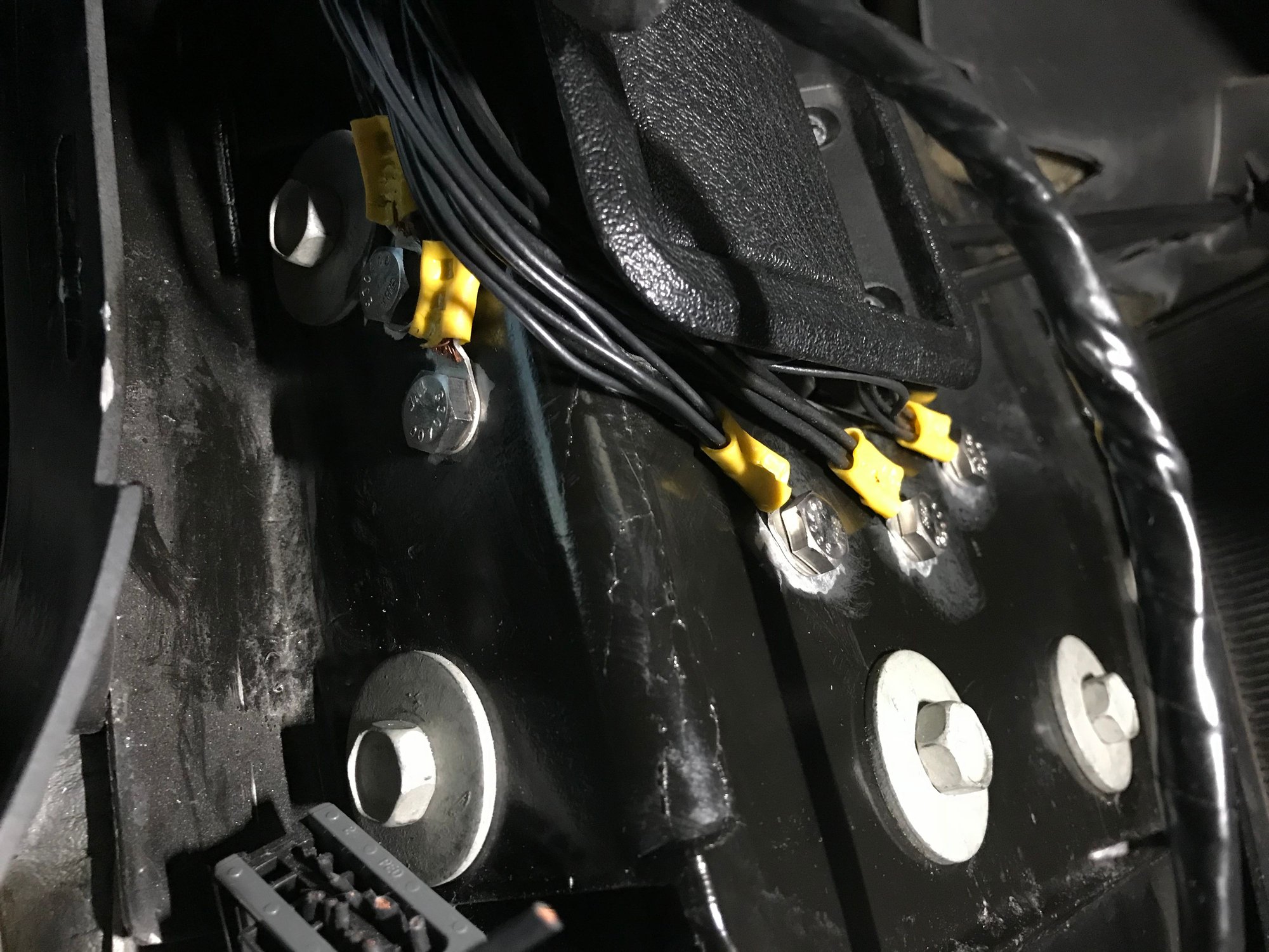

Just spent the weekend going through the entire car cleaned all grounds except those connected to the engine. G201 and G202 were my suspected culprits. In my attempt to unbolt those I damaged and ended up cutting the ground wires free and cleaned up. It actually turned out pretty nice and I was able to do this with parts and tools I had lying around. I believe this way is superior to the oem pins/terminal stake. I should also note that the previous owner installed a stereo and was a hack, I found one ground that was fried I assume this was causing my issues but who knows. Anyway I thought this may help someone who can’t access those two grounds and is willing to drill and tap some holes

Nice Job. I did the same thing last year. I left the stock wires on the post but added new connectors to the old wire ends, and then added a new wire over the factory's- doubled them up. No more gremlins...
