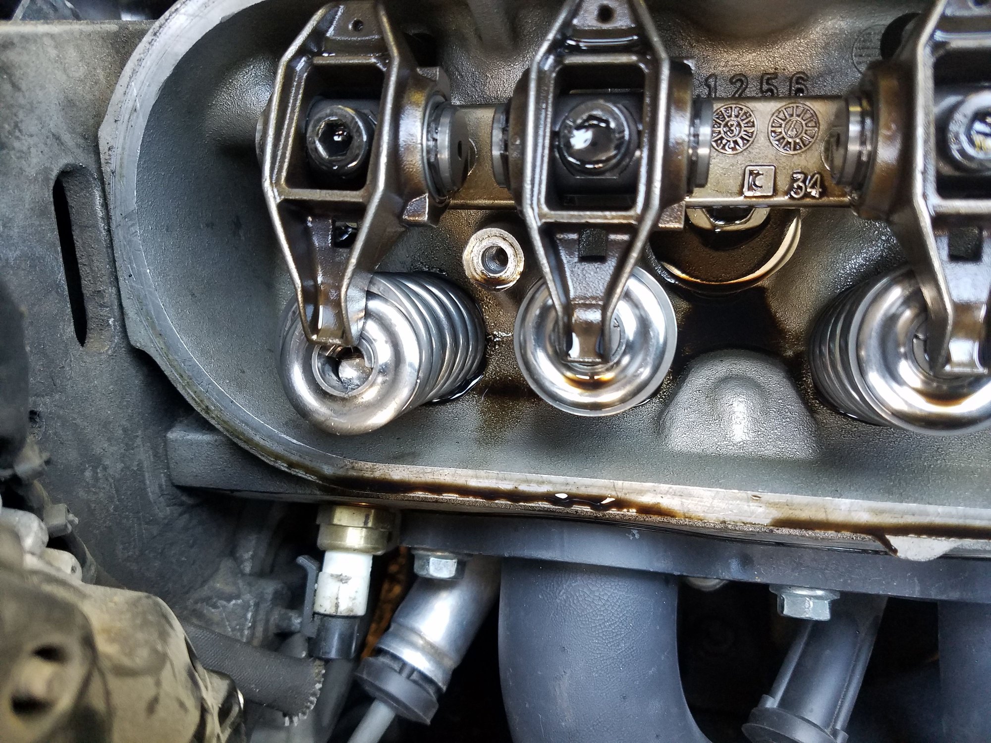

Originally Posted by Rob 02
1. There is probably more damaged valves than what you can see.
2. Exhaust fumes could be getting into your intake and that doesn't provide good O2 for any remaining good cylinders.
#2 is very likely. Based on what I can see in the intake tract, anything that's getting in that cylinder and igniting when the spark plug fires, would blow back into the intake because the valve is not sealing against the head.

The carnage that I have discovered so far. Hopefully will have time to get the heads off tomorrow.

Well... new piston, and new heads are in order... fortunately the cylinder wall is clean, so just a simple swap and go.
It happens when your driving at the top of the rev range in third gear.
You hit the clutch to slam it into fourth and go into second accidentally.
What happens is the engine revs up to about 13,000 RPM and the valve springs can't hold the valves closed at that rate of speed. The open valves hit the pistons.
Normally the rev limiter keeps this from happening.
People usually deny this when first asking for mechanical advice.
yeah, but not in this case. It dropped the intake valve, looks like the valve got sucked down and stripped out the keeper. Only 1 piston was damaged. No other damage upon pulling the heads
