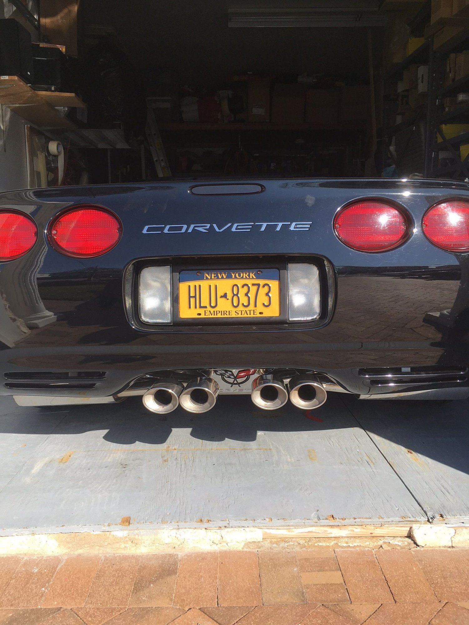

These are the tips

Originally Posted by pjdbm
These are the tips
I believe you have these..
http://m.ebay.com/itm/281130872434?_mwBanner=1

Originally Posted by bwill03z
ahh, he went low budget on the exhaust
Oh well, its new and it will have to be for now, thanks for cluing me in
Oh well. It still looks good and as long as you are satisfied with the sounds thats all that matters. Name brand exhaust systems for these cars are pricey. I bought mine used off of a forum member.
