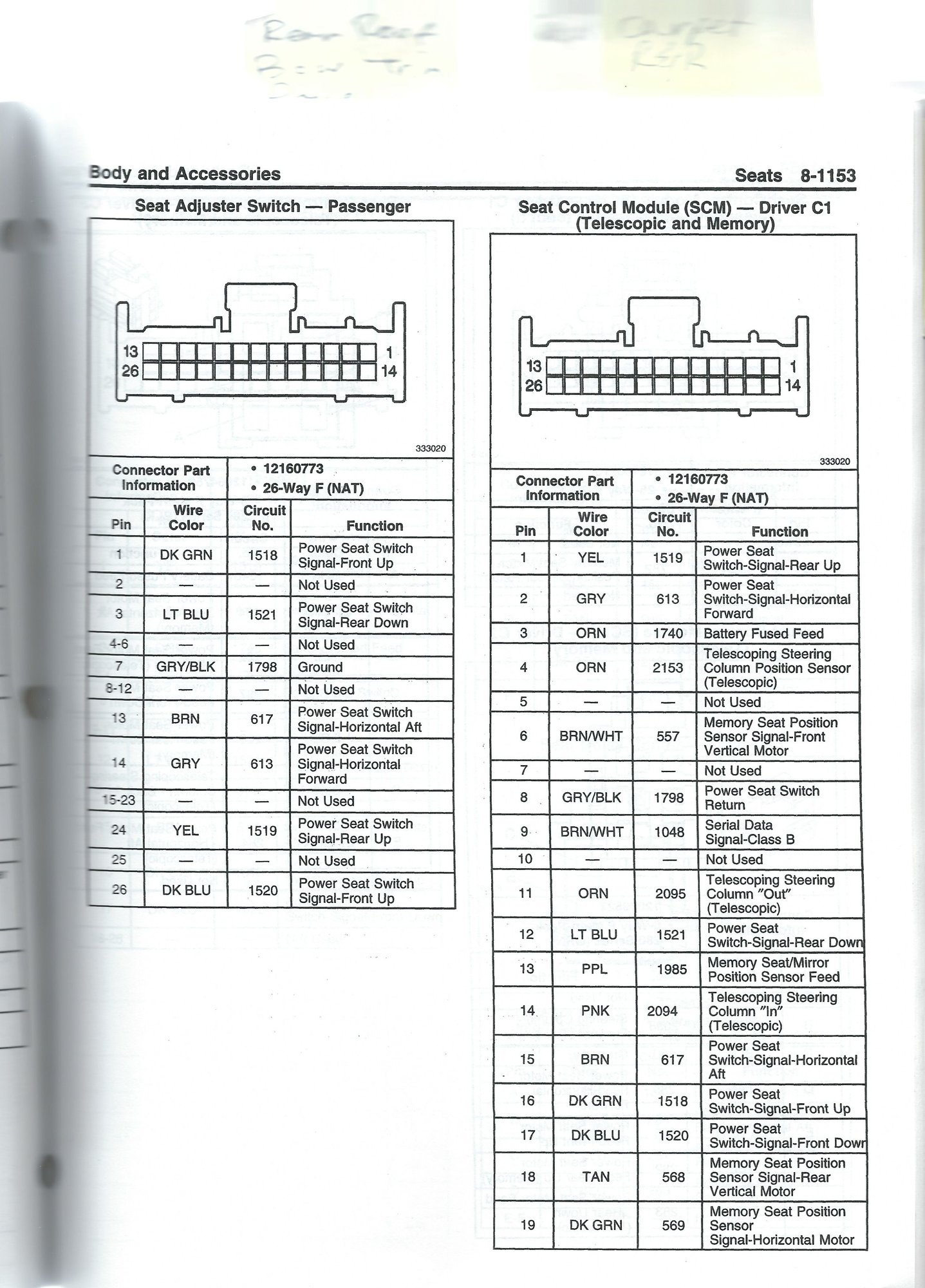

Seat stopped working so I took it apart. I found that the green wire and tan wire had been pulled out of their respective spots on the plugs. Can someone tell me where (which hole) these go into?

It would help if you sent a picture of the plugs involved. I am thinking that you have telescopic and memory options since the FSM shows green and tan wires for that application. Here are a couple of scans that might help.
