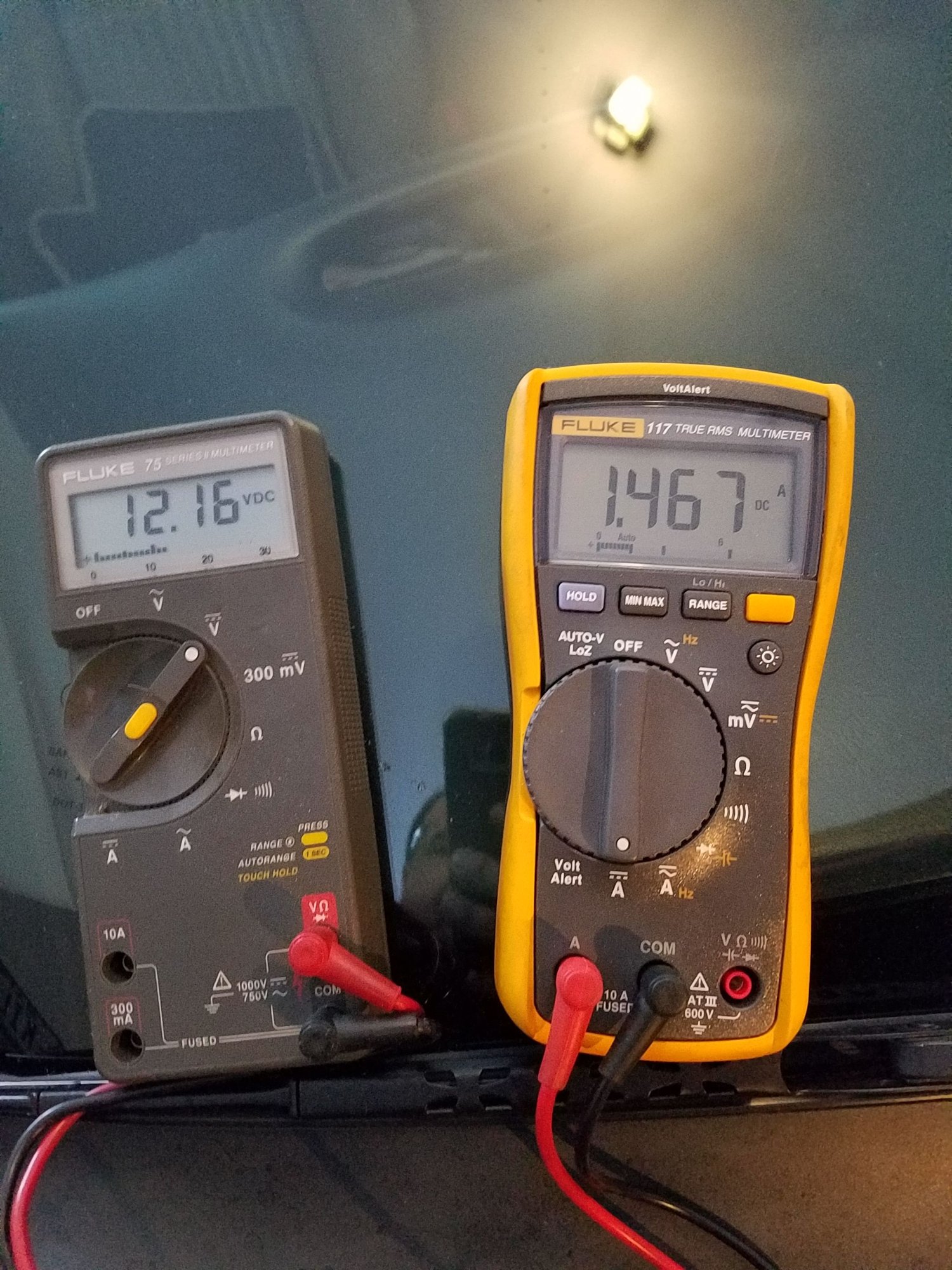

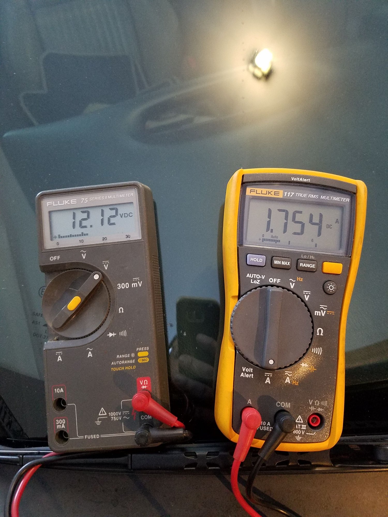

After about a minute
After about 15 seconds......
Voltage and current readings right after connecting meter in series. Note under hood light was on, everything else closed and off.
The set up I used
Since we are still buried in snow and freezing temps I was board and did some current draw testing on my 99. I've never had a dead battery and do not keep mine on a tender when not in use. Admittedly the longest it sits without being driven is maybe 2 weeks. Captions are in pic attached. Hope this helps others.

After about 15 minutes the under hood light went off and the current draw dropped to 30mA. This is about what it should be from the reading I have done.
