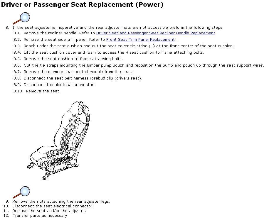

The removal process is detailed in the FSM page 8-1147. I don't have time to type it all now, but you basically remove the seat cushion and get the seat our from there. Sounds fairly complicated (I've never done it), but obviously it can be done. If no one else helps, I'll type the instructions for you tomorrow afternoon.

here are details:

Thanks Voda,
I got the seat cushion up and since the seat seemed to want to go backwards , I just reversed the wires on the adjuster motor so it would go forward when the switch was moved in the backwards position. Ņext is to fix the seat adjuster, and dry the carpet, I had a leak in the tonneau cover seal due to gunk in the drain channel and poor seating of the seal. I wonder what else I will run into today !

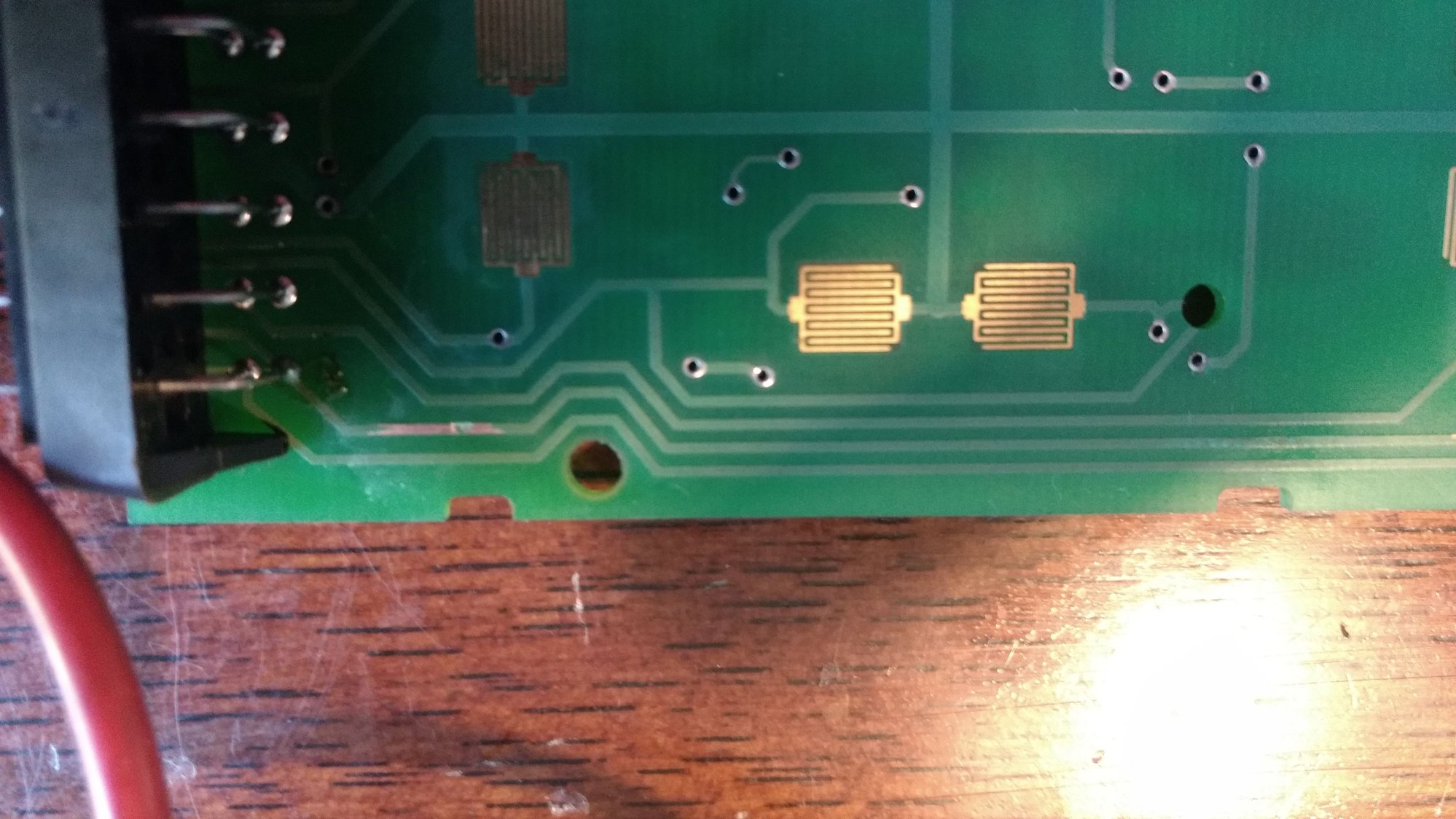

So while the carpet was drying i decided to tackle the power seat problem. Thinking it was a relay in the SCM i resoldered them with no luck. So i did some static tests on the seat control switch and found a broken trace. This is probably a one off problem since i have never seen a broken trace like this. You can see where I scraped off the coating. Soldered a jumper across the gap and it works like a charm.
