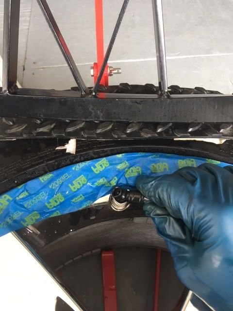

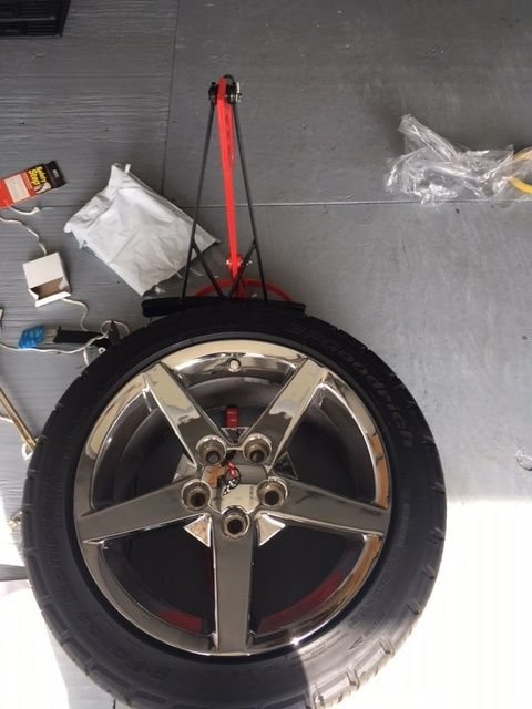

I purchased a Harbor Freight bead breaker for $40.00 and decided to try and change my TPM sensors today.
Wasn't sure these large rims would work with this tool and was set to return it if it didn't.
I got the front two done within and hour and a half, that included jacking up the vette and removing tires.
I used painters tape in the area of contact and also laid a piece of plywood over the rim so it didn't get damaged. It was not simple but very doable with patience and soapy water. After the fronts were done, I did test them and they work, a pleasure to hear that horn go off
Tomorrow will be the rears

thanks, and by the way, I had absolutely no problem filling the tire back up after sensor was installed.
The aluminum nut should be torqued to about 60 inch lbs

From all the reading I did on this, this should be no problem, all I opened up was the area of the valve, I didn't even break the back bead.
I just broke the bead enough to access the sensor, I had to search deep for the proper torque, the company I bought these from told me around 24 inch lbs, they were a tad off lol

I have a regular 20 gallon compressor and just filled them normally without doing anything extra. I guess the low profile tire keeps it tight enough.
i have read stories where people take the cars to professional?? Shops and they confuse inch lbs with foot lbs and destroy the sensors. I have very little confidence with the mechanics and especially the tire shops around me here on Long Island.
I doubt very much that they use a torque wrench on the either.

Thanks for the kind words, I finished the rears today, the rears were harder than the fronts.
In the future, I will do maybe one or two but not all four, I am 52 and the risk of injury with the force/pressure that needs to be applied getting access with a low profile tire may not be worth it, when I get older will probably take the wheels to a shop and then recheck their work.
It was interesting and a hell of a experience. Oh, I got them all programed and what a joy it is to have the tire monitoring system working. I took her out for a cruise and all tires are good.
