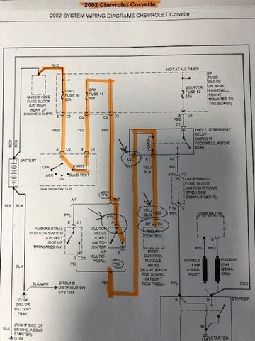

I've enclosed a pic of the 2002 starting circuit...I would see if you have 12 volts at the purple wire (terminal A) of the clutch switch with key in START position...if good move down to terminal C2 of the TDR relay which is the yellow wire...for the TDR relay to close that wire finds a ground from the BCM (relay control)...you can jump the red and purple wire directly (load side) and the should crank but make sure the car is in neutral !!....the TDR relay may be bad OR the BCM is not supplying a ground to the relay control !!

Simple TEST! Have an assistant Do all that is required to crank the engine "except" turn the key to CRANK. There is a Theft Deterrent Relay (TDR) in the passengers foot well on the fire wall above the big silver box (BCM) It has FOUR WIRES Yellow, Yellow/Black stripe, Purple and Red.
When the ignition switch is turned to CRANK you should hear that relay "CLICK"
That causes the contacts to connect the Purple and red wires together and the 12 VDC power goes out to the Starter Solenoid and the solenoid engages the starter and cranks the engine.
See if that relay is actually clicking. I have a manual C5 and I actually hold the key to CRANK and bump up & down on the clutch peddle safety switch and can hear that relay from the drivers seat.
If the relay is clicking, you at least have a functioning control circuit. To see if the relay is actually functioning (providing the solenoid 12 VDC) you would need a meter.
Our C5s have a well documented issue with the Starter SOLENOID. They STICK and cause the exact symptoms you describe. If you whack the solenoid/starter while HOLDING the key to CRANK and it cranks, you need a new solenoid.
