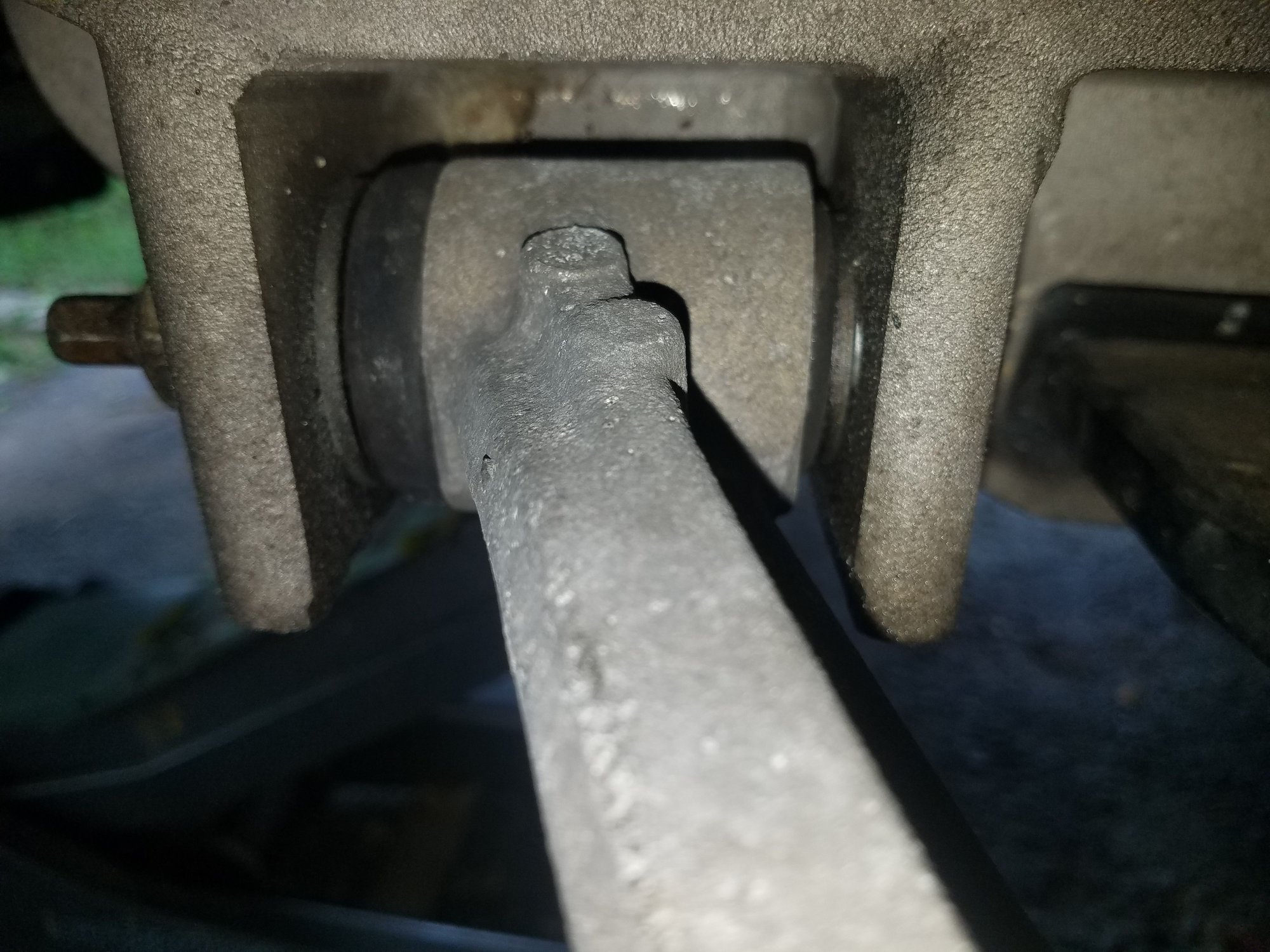

Third thread revival is the charm. I think I might be putting an end to this mystery. I've dealt with this issue since I got the car, threw a lot of parts at it, some worthwhile, some needless. Can't stress how important it is to really really inspect every part of a front end. I have no experience with double wishbones suspension, so I seem to have glossed over my lower control arm bushings. I knew to inspect the uppers, but alas, the lowers are hopefully where my issue resides.
Check this picture out!
Now that doesn't look right, does it? Anyways, that's the worst looking bushing of the lot, one rear looks fine, but the other 2 are also very suspect. A prybar revealed quite a lot of deflection when pressure was applied. I believe I've found my issue, could have resolved this months ago with a little bit of patience and a keen eye. I understand this happens under hard acceleration and deceleration as the car frame wants to slide forward and back within the bushing. I believe at higher speeds, the speed of the deflection in the bushings increases, giving me slight, but noticeable feedback through the wheel.
Now I'm shopping for either used LCA's, or buying a bushing kit and tackling the install on those. Anyone have suggestions for which way to go? Mild auto-x but mostly street car, I'm hesistant to go used as the bushings will likely do the same thing again. The ease of install of new arms is appealing though.
