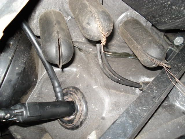

clean your udders, the circuit board in the motor could be cracked !! (when water doesn't drain it cooks the wiper motor !!)

Thanks for the response Pounder.
The udders are clean - that was the first thing I checked, as I'm combating some moisture issues in the cabin. So I don't think water is building up near the wiper motor - though there's definitely moisture elsewhere.
Everything about the wiper operation seems to be fine other than this one behavior. And when the wipers park, I can see the parking pin dropping into place, as I think it's supposed to. It just doesn't stay parked.
