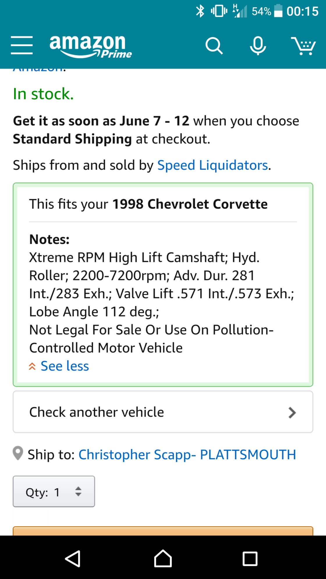

I am a long time browser and minimal poster, but I'd like to start getting more involved the community here. I have had my Vette for about 4 months now and love it (98 Targa). So far I have added C6 ZO6 shocks, bypassed the VATS system, overhauled the interior, added a remote start system, added a double din nav, replaced all speakers, dual ram CAI, fixed headlights, and upgraded to drilled and slotted rotors. This week, I'll be rebuilding my top end and adding LTs and an X-pipe. Here are the specs and pics of the parts of my build:
1 7/8 LT 3" x-pipe
Comp Cams beehive valve springs
7.425 push rods
281/283 .571/.573 LSA 112 Comp Cam and lifters
42lb injectors
Holley EFI 102mm TB
Holley 102mm Sniper EFI
Holley tall powdercoated valve covers
New plugs and wires
I'll be doing this all at once and plan to do a Yank 3600 and 3.90 gears in the near future.

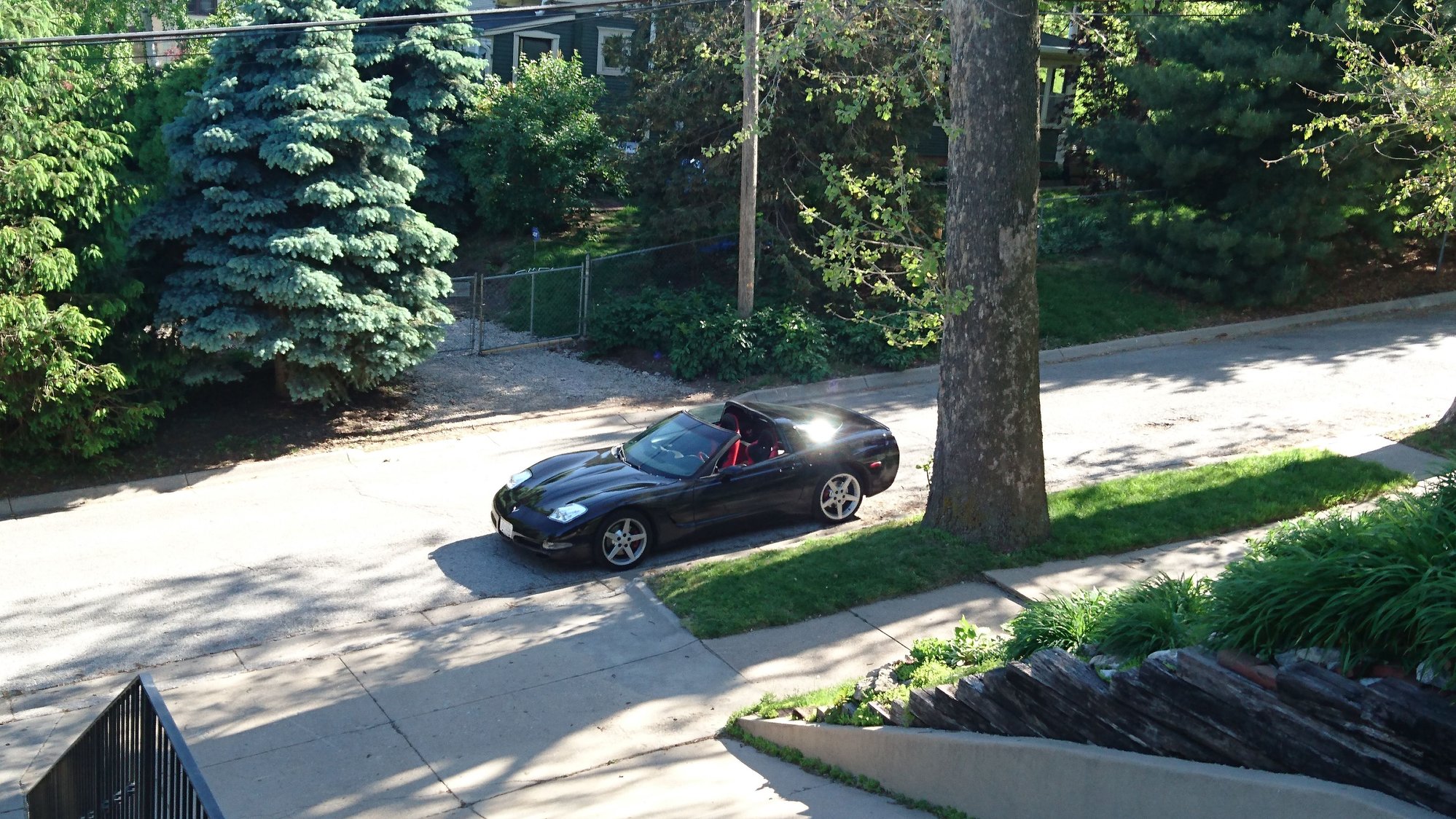

Default Some pics of my girl
Topless
New headlights New turn signals
Cleaned up wheels 18/19, D&S rotors, painted calipers.
Did i read that cam duration spec correctly? Can't be right...
To My first Vette build
