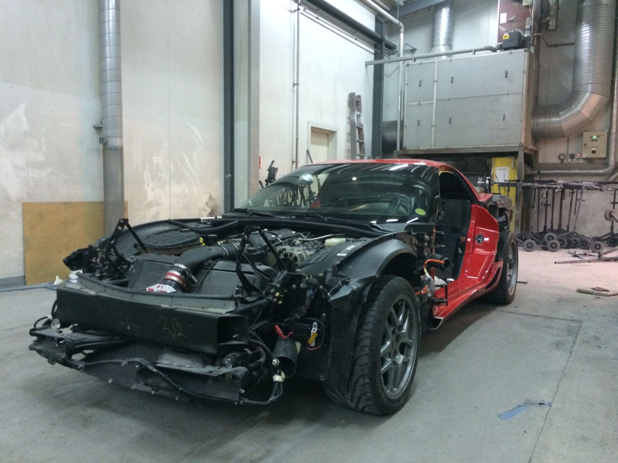

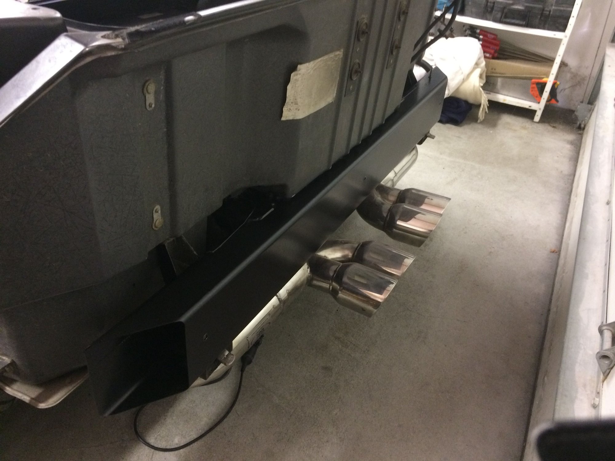

I´ve been there half a year ago. As others have posted its pretty easy to remove front/rear fascia and front fenders. The rear fenders (quarter panels) have a few screws in top where the fender lines up with the roof, but you cant access those. I found it possible (as many others) that you can work the the quarter panel from side to side carefully, and eventually it will come loose. I dont have pictures, but do a search and it will be pretty forward.
At this point it was easy to perform a good paint job:
A good advice: this is the perfect chance to do a little clean up behind those panels. It´s much more easy to do now when things are apart. Remove dust & dirt, clean up wires and make sure to re-route them in the same way. If anything is broken or insulation worn out, its easy to solder it now. I noticed that exhaust gas had made a little corrosion at the rear frame - so I took my chance to sand and paint - and now it looks like new.
