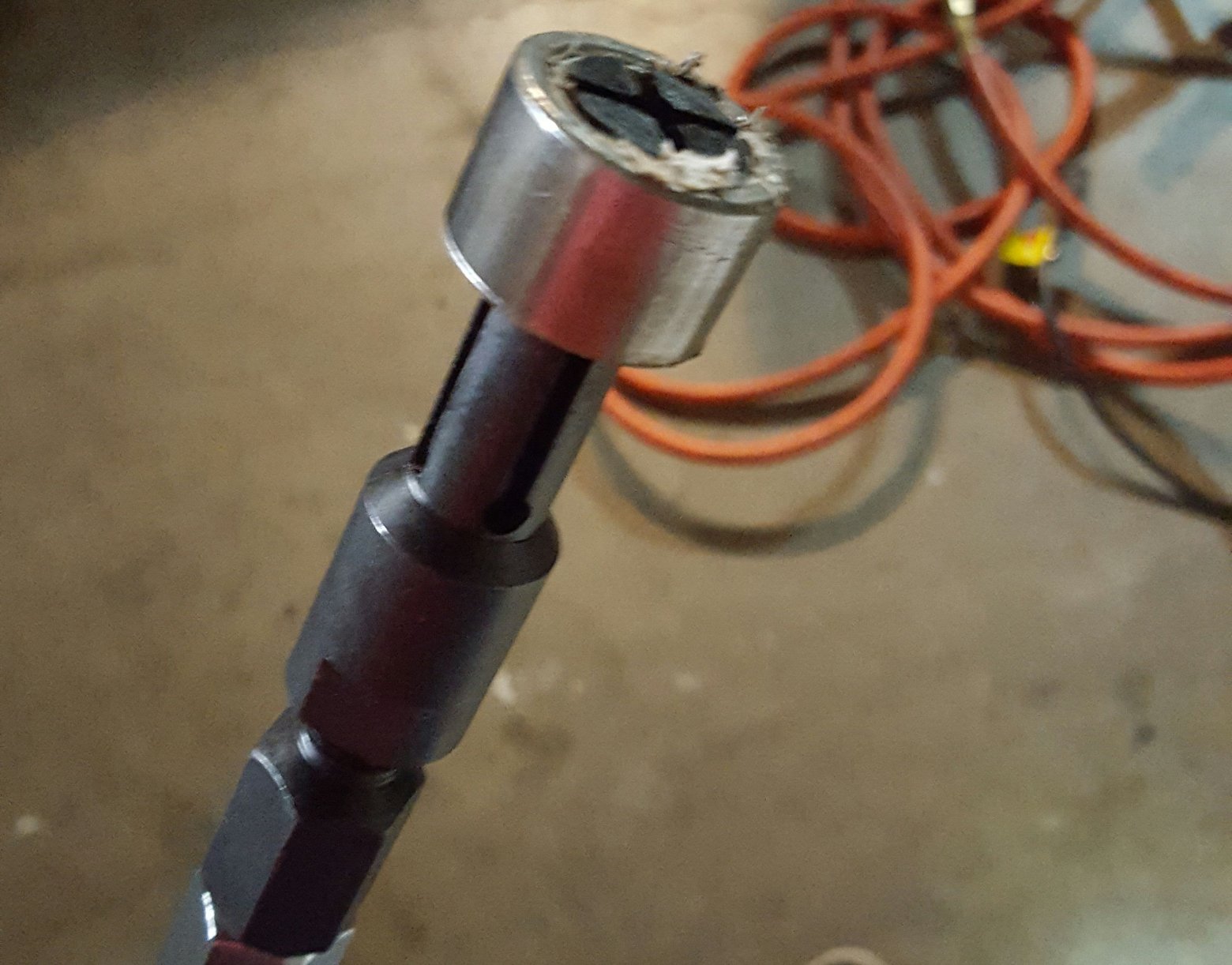

Blind hole puller worked for me. 5 minutes of slide hammering. Got this at Harbor freight. Part number 62601
Old Jun 10, 2017 | 01:03 PM
SVT_Z06's Avatar
SVT_Z06
Joined: Aug 2010
Posts: 472
Likes: 9
From: San Diego CA
